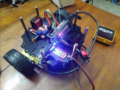

Introduction: Gesture Control Robot
It is a gesture-controlled robot which is controlled by sending commands from an M5Stack ESP32 board.
I always wanted to work on a gesture-controlled robot that can be controlled by my changing the orientation of my hands.
I used an M5Stack ESP32 board which contains an in-build IMU sensor for detecting the gestures. The gestures are detected using the accelerometer. The acceleration in the X and Y axis data are send to the onboard EPS32 of the robot using the ESP-NOW protocol.

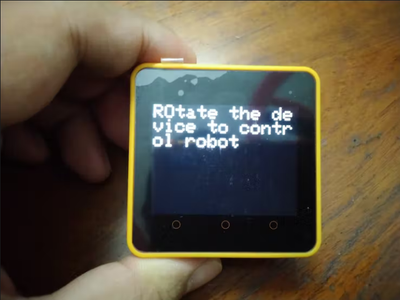

Step 1: M5Stack AWS IOT Edukit Core2
The Core2 for AWS comes with an ESP32-D0WDQ6-V3 microcontroller. The main unit is equipped with a 2.0-inch capacitive touch screen that provides a smooth and responsive human-machine interface. It also comes with an MPU6886 which provides a 6-axis internal IMU.
I have used the IMU and the Screen for this project. The accelerometer of the IMU is used to get the tilt direction of the M5stack device.

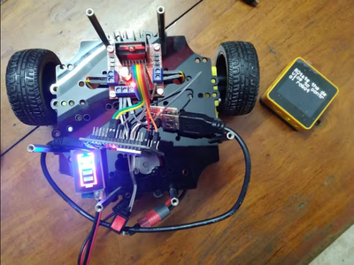

Step 2: ESP32
Circuit Connection
ESP 32 Pins < -- > L298n Motor Driver
GPIO 14 < -- > Motor 1 PWM
GPIO 27 Motor 1 IN1
GPIO 26 < -- > Motor 1 IN2
GPIO 25 < -- > Motor 2 IN3
GPIO 33 < -- > Motor 2 IN4
GPIO 32 < -- > Motor 2 PWM
