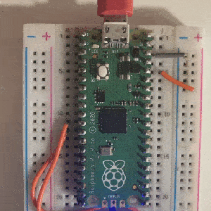

Make all the connections as per the above connection. Here's my setup:
Blinking the onboard LED
With that, you’re now ready to get it working.
