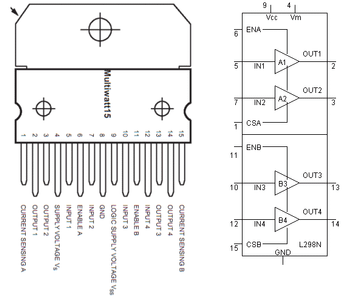

Selection of motor driver IC is depend on the motor you use. Each motor driver IC have different specifications. You can find detailed specification on manufacturer’s website. For use with Johnson, I have L298N. You can use L293D with Vega motors.

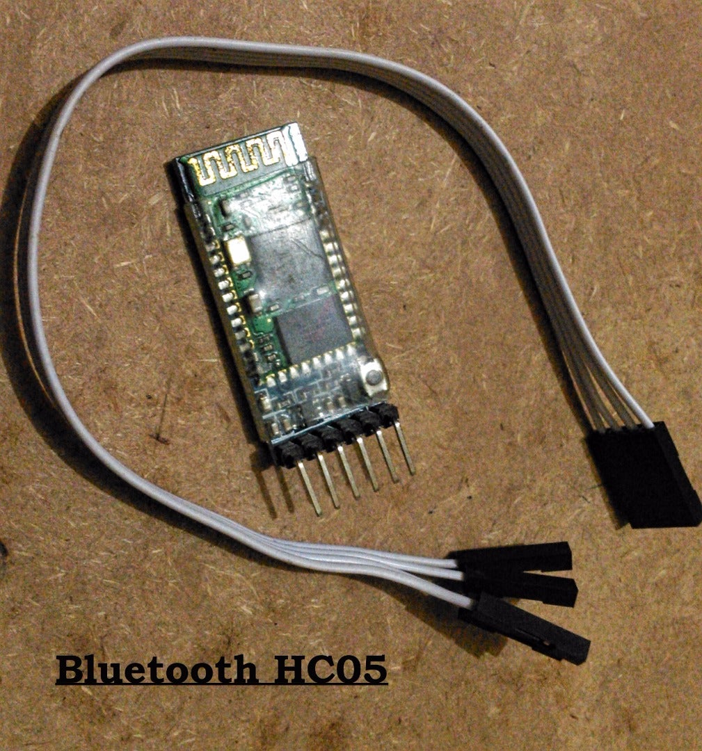

Bluetooth:
We can use different types of Bluetooth module like hc-05 or hc-06 in this DIY. One can find data sheet for both the module on internet.

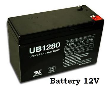

Battery:
There are different types of rechargeable battery available like li-polymer, li-ion, pb-acid, etc. they are in different mAH and voltage. One can choose from them according to cost and requirement.

· 1x Bluetooth module hc05
· 1x motor driver IC L298N

· 1x rechargeable battery 12V for IC

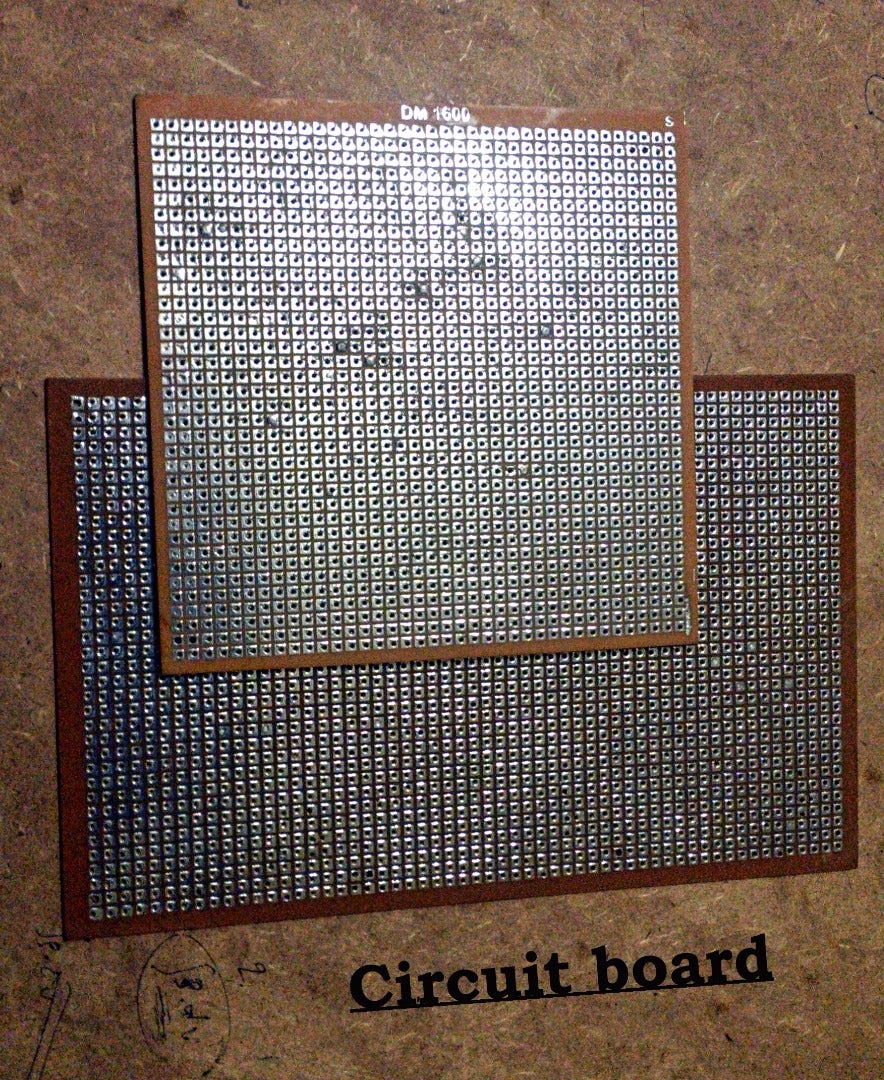

· Circuit board(small)

Step 4: Circuit Diagram
I insist you to connect whole circuit on breadboard before
soldering it on circuit board because there is a chance to make mistakes in connection at first try. Before moving forward, I would suggest you to refer specification of all electronics part.
Connect circuit as shown in figure on bread board with driver IC, Arduino Uno r3, Bluetooth hc05. Connect motors in the output terminals.

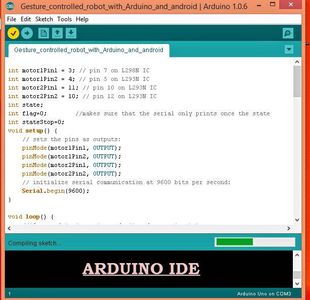

Step 5: Upload the Sketch to Arduino
You can load new programs onto the main chip - ATmega328p – of Arduino Uno r3 via USB using the Arduino IDE. Visit the link below to download the latest Arduino IDE:
http://arduino.cc/en/Main/Software
The official Arduino website does a great job explaining how to do it any of the three operating systems (Windows, Mac and Linux).
Connect your Arduino UNO to your computer via USB. Open your Arduino IDE. Open the file attached below.
By default your Arduino IDE comes pre-configured for the Arduino UNO. Make sure that you have selected the right port. If you haven’t then you can change it from tools menu. Bottom right corner of IDE of Arduino shows the current configuration.
Left-click the “Upload” button and wait a few seconds until a “Done uploading.” message appears. You don’t required to reset Arduino Uno r3 before uploading a new sketch because it is itself replace the earlier sketch with new one.

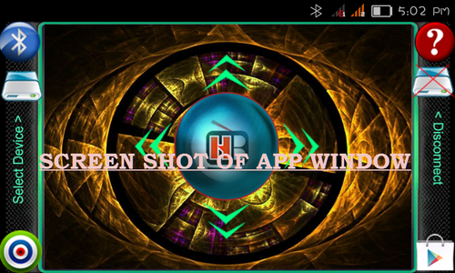

Step 6: Android App
You can write application for this if you are developer. You can easily find source code for this. But as I am not a developer, I would better preferred to search for app on play store. I have provided link to download app which suits better with this DIY.
You can also use any other app by modifying the code which is uploaded on Arduino.
APP: BLUETOOTH ROBOT CAR CONTROLLER by hobbyprojects.com available on play store.

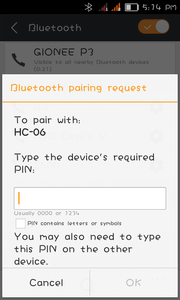

Step 7: Pair and Connect Bluetooth
You have to pair your phone’s Bluetooth with Bluetooth module HC05 before you connect it from application.
Power the circuit or Bluetooth and then go to menu>> settings>> Bluetooth. Turn it on and search for nearby devices. Find HC05 and pair it.
Note: If the HC-05 Bluetooth Module asks for a password, it’s '1234'.
After pairing the Bluetooth module with phone’s Bluetooth, start the application. Touch on select device and select HC05 from it. Prompt shows that device connected successfully.at that time keep mobile parallel, screen upwards.
Now move phone in forward, backward, left and right direction and make sure that motors working properly in each movement. If it rotates in wrong directions, you have to correct it by interchanging positive and negative terminal of motors.
