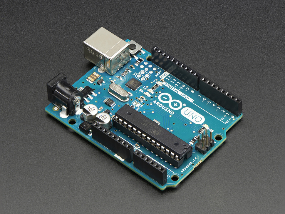

Step 1: Materials Required
For transmitter-
- Arduino Uno
- ADXL335 accelerometer
- 433 MHz RF transmitter
- Breadboard
For receiver and robot-
- Arduino Uno
- 433 MHz RF receiver
- L293D motor driver IC
- Chassis and wheels
- 2 DC motors
- Breadboard
Of course you will also need jumper wires and 9V batteries
Instead of using the Arduino and breadboard in transmitter like I did ,you may instead use an ATMega328p, which can be programmed from the Arduino board and solder it along with RF transmitter and ADXL335 on a perfboard.
The perfboard can then be attached to a glove.However here I've used a remote controller like setup with the gestures the same
