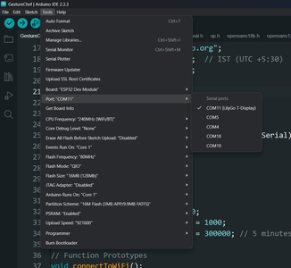

Step 8: Programming
Download and install the required libraries:
Download the GestureChef repository, extract the files, and open GestureChef.ino in Arduino IDE.
If you haven’t already configured the ESP32 environment in Arduino IDE, follow this guide:
- Visit: Installing ESP32 Board in Arduino IDE.
- Add the ESP32 board URL in the Preferences window:
- Install the ESP32 board package via Tools > Board > Boards Manager.
- Install Arduino ESP32 V 2.0.5 or above and below V3.0
Enter your WiFi credentials
Change time zone, for me I am in India (IST 5:30) so calculate the offset as 5.5x60x60 = 19800 sec
Select the settings in Arduino IDE as shown in above image.
Connect the display to PC using Type-C cable.
Click on "Upload" and wait for the process to complete.
Once uploaded, your GestureChef is ready to serve you meal ideas with just a swipe!
