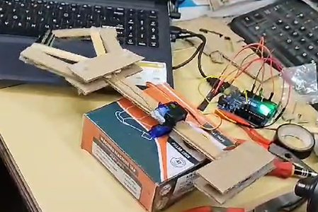

Drawing from their expertise in electronics, computer vision, and machine learning, the team began developing a prototype. They decided to use an Arduino board to control a robotic arm made of simple materials like cardboard—proving that innovation doesn't always require expensive resources. The key component of their system was a hand-tracking module that could precisely interpret hand gestures in real-time using a webcam and computer vision algorithms powered by Mediapipe.

Welcome to this exciting project where we'll build a gesture-controlled robotic arm using Arduino! This project combines the power of computer vision with the versatility of Arduino to create a robotic arm that you can control with simple hand movements. Whether you're a beginner looking to dive into the world of robotics or an experienced maker seeking a fun weekend project, this Instructable is for you.
[Insert a cover image of your completed robotic arm here]
In this project, we'll be using:
  1. An Arduino Uno
  2. Two servo motors
  3. A webcam for gesture recognition
  4. Python for computer vision processing
  5. Arduino IDE for programming the microcontroller
Let's get started!

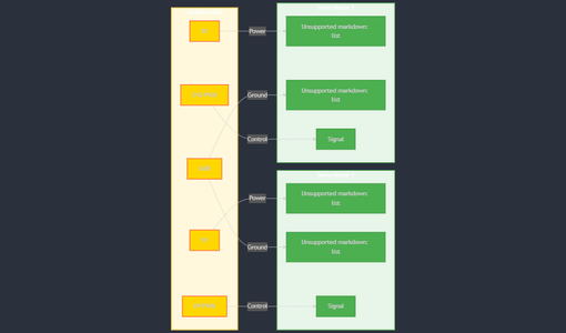

Now, let's program the Arduino to control the servos:
  1. Open the Arduino IDE on your computer.
  2. Create a new sketch and paste the following code:
cpp
Copy
#include <Servo.h>
Servo servo1;
Servo servo2;
void setup() {
servo1.attach(9);
servo2.attach(10);
Serial.begin(9600);
void loop() {
if (Serial.available() > 1) {
int angle1 = Serial.read();
int angle2 = Serial.read();
servo1.write(angle1);
servo2.write(angle2);
