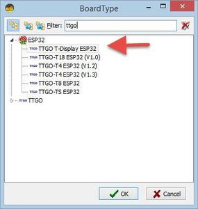

Step 2: Start Visuino, and Select the Arduino TTGO T-Display ESP32 Board Type
The Visuino: https://www.visuino.eu also needs to be installed. Download Free version or register for a Free Trial.

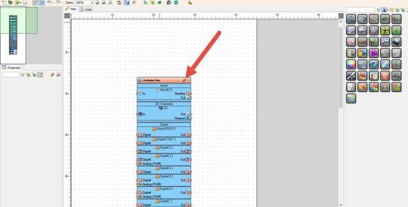

Start Visuino as shown in the first picture Click on the "Tools" button on the Arduino component (Picture 1) in Visuino When the dialog appears, select "TTGO T-Display ESP32" as shown on Picture 2

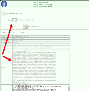

  • Go to https://projects.petrucci.ch/esp32/?page=ssl and paste the https://api.coingecko.com in the Edit box and click "Get Certificate" button (Picture1)
  • Click on the "DigiCert SHA2 Extended Validation Server CA" Image (Picture2)
  • (Picture 3) In the Table below "cert:" select the certificate field and copy it to the Clipboard (you will need it in the next step)

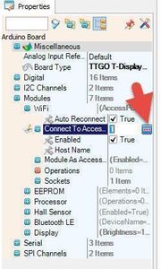

  • Select TTGO T-Display ESP32 board and in the properties window expand "Modules>WiFi>Connect To Access Points
  • Click on the Connect To Access Points 3 Dots
  • In the AccessPoints window drag "WiFi Access Point" to the left side

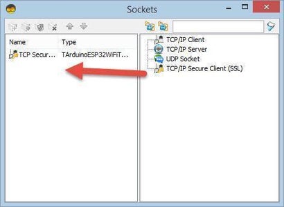

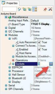

  • Select TTGO T-Display ESP32 board and in the properties window expand "Modules>WiFi>Sockets
  • Click on the Sockets 3 Dots
  • In the "Sockets window" drag TCP/IP Secure Client (SSL) to the left
  • In the properties window set Host to: api.coingecko.com
  • select "CACert" and click on the 3 dots button and in the "CACert window" paste the Certificate that you got in the previous step
  • Close the "Sockets window"

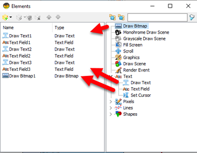

Select TTGO T-Display ESP32 board and in the properties window expand "Modules>Display>Elements" Click on the Elements 3 Dots

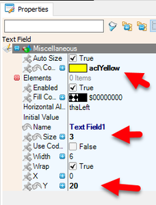

  • In the Elements window Drag "Draw Text" to the left and in the properties window set size to 2 and text to High $
  • In the Elements window Drag "Text Field" to the left and in the properties window set size to 3color to "aclGold" and Y to 20.
  • In the Elements window Drag another "Draw Text" to the left and in the properties window set size to ,text to Ch % 24 Std and to 48.

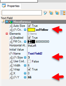

  • In the Elements window Drag another "Text Field" to the left and in the properties window set size to 3color to "aclGold" and to 66.
  • In the Elements window Drag another "Draw Text" to the left and in the properties window set size to ,text to LAST $ and to 92.

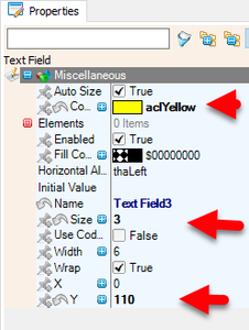

  • In the Elements window Drag another "Text Field" to the left and in the properties window set size to 3color to "aclGold" and to 110.

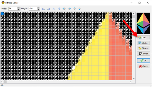

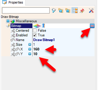

  • Optionally you can add bitmap to the Display, to do that in the Elements window drag "Draw Bitmap" to the left side and in the properties window set to 160to 10
  • Click on the Bitmap 3 Dots
  •  In the Bitmap Editor Load the Ethereum bitmap (picture 1) and close the Bitmap editor
  • You can find other bitmaps at https://iconarchive.com/search?q=crypto

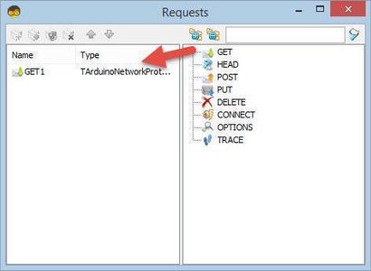

  • Click on the Requests 3 Dots
  • In the "Requests window" drag "GET" to the left side

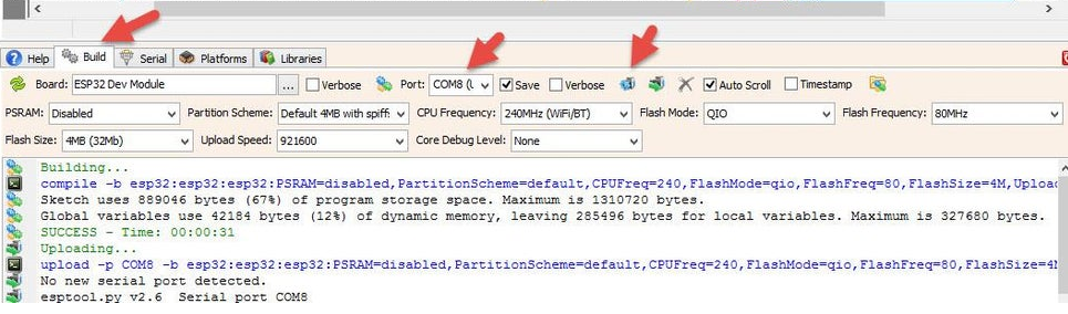

In Visuino, at the bottom click on the "Build" Tab, make sure the correct port is selected, then click on the "Compile/Build and Upload" button.

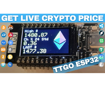

If you power the TTGO ESP32 module it will connect to the network and display the current Bitcoin price data.
Congratulations! You have completed your project with Visuino. Also attached is the Visuino project, that I created for this Tutorial, you can download it and open it in Visuino: https://www.visuino.eu
