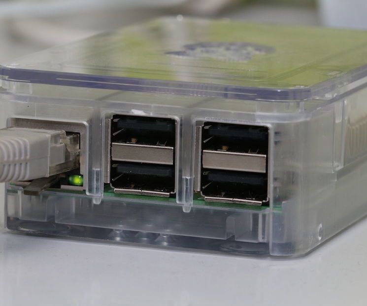

With a Raspberry PI at home and a real need to, sometimes, access it remotely, whether by ssh or any other service I wanted a simple way to always have by hand my home dynamic public IP address. Also a requirement, no need to subscribe a third party service for that. Having some knowledge in Node.js, I started looking into it. Later I found that my IP doesn't change so often as I supposed... Good, i don't feel bad for having opt for e-mail notifications! :)
