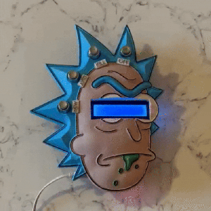

A 3D printed face of Rick Sanchez, with a LCD screen that displays Rick-like sentences based on a Markov Chain I've built using the transcripts of the sitcom.
You can watch it and enjoy weird sentences being generated, sometimes absolutely boring, sometimes magnificient SciFi madness...

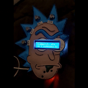

Then you can run Rick_Box_Screen_Button.py and press the "NEW" button, it should give you a Rick-like sentence!
The "AUTO" button gives you sentences until you press it again, the "KILL" button restarts the Rick_Box_Screen_Button.py code, and the "OFF" button turns the Pi off.

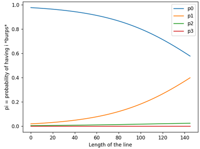

One feature I really loved in the video of Code Bullet was to mimic Rick's belching style. So I started how to do it based on my data at hand. I ended up with a nice categorical law (I guess) depending on the length of the genrated line, with nicely fitted curves: that's the numbers you can find in the list "r_fit" in the Rick_Box_Screen_Button.py" file. In my notes, I just found: "a 'categorical draw' with the probability 'parametrized' by the length of the generated line". Yummy.
From there, the idea was to generate the line with the Markov Chain, then draw the number of *burps* based on the length of the line, and finally insert them randomly in the sentence.

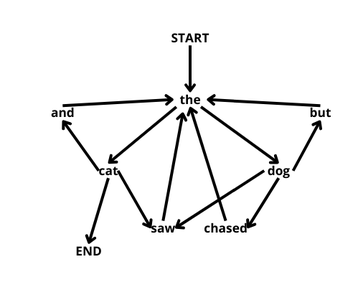

Then plan here was to use a Markov Chain to represent all the data we got. Let's take a super simple example: "The dog saw the cat and the cat saw the dog, but the dog chased the cat.". If we do not care about the case ("t" is the same as "T"), then we can represent this as a simple graph. Here transition had the same probability, but it can vary, you can use not only the word before, but the two previous words, etc.
Thus I wrote a function "generate_MMn" that encodes that kind of graph into a .json file. You will find it in the build_MM.py file.
This function gives files like "data_MM2.json". Feel free to try other orders to see the effect!
