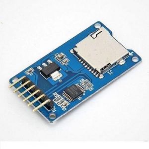

  • SD card module

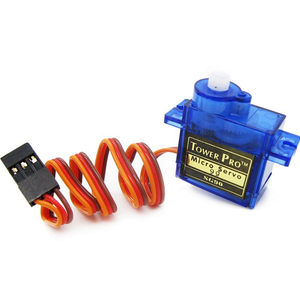

  • Servo motor

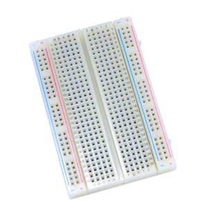

  • Breadboard

  • Connect SD card Module pin GND to Arduino pin GND
  • Connect SD card Module pin VCC to Arduino pin 5V
  • Connect SD card Module pin SCK to Arduino digital pin 13
  • Connect SD card Module pin MISO to Arduino digital pin 12
  • Connect SD card Module pin MOSI to Arduino digital pin 11
  • Connect SD card Module pin CS to Arduino digital pin 10
  • Connect Servo motor "Orange" (signal) pin to Arduino Digital pin[2]
  • Connect Servo motor "Red" pin to Arduino positive pin[5V]
  • Connect Servo motor "Brown" pin to Arduino negative pin[GND]

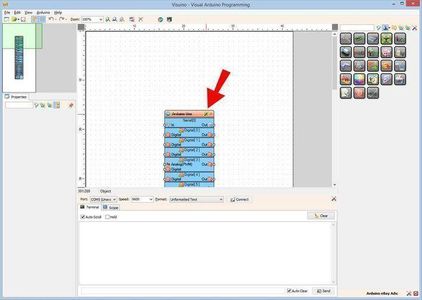

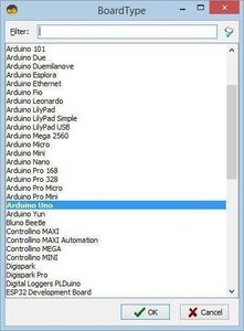

Step 5: Start Visuino, and Select the Arduino UNO Board Type

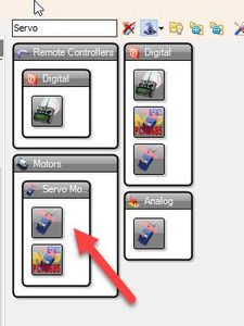

The Visuino: https://www.visuino.eu needs to be installed. Start Visuino as shown in the first picture Click on the "Tools" button on the Arduino component (Picture 1) in Visuino When the dialog appears, select "Arduino UNO" as shown on Picture 2

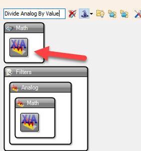

  • Add "Divide Analog By Value" component

  • Select "DivideByValue1" and in the properties window set "Value" to 180

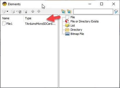

  • Double click on the "SDCard1" and in the "Elements" window drag "File" to the left side and in the properties window set "Path Name" to SERVO.TXT

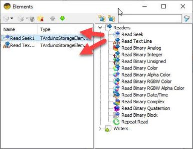

  • Select "Elements" and click on the 3 dots button and in the new "Elements" window:
  • Drag "Read Seek" to the left side and in the properties window select "Position" and click on the pin icon and select "Cardinal SinkPin"
  • Drag "Read Text Line" to the left
