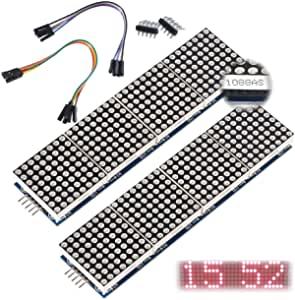

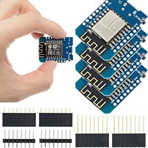

Connect a Dot-matrix LED display 8x32 to your esp8266 board
You need to follow the pinout mapping according to the board type you use, you will find the connectivity instruction on the code
