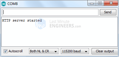

Once you have uploaded the sketch, open the Serial Monitor and set the baud rate to 115200. Press the RESET button on the ESP8266. If everything is working correctly, you will see the message “HTTP server started” displayed.
