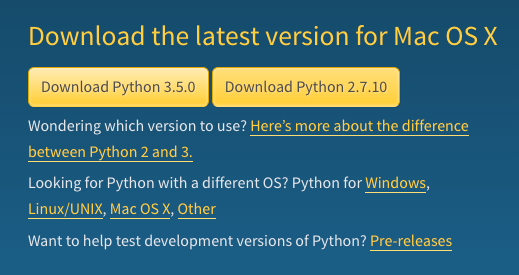

Head over to https://www.python.org/downloads/ and download the latest release available with the big yellow button.
Then follow the Installer Instructions to install python.
