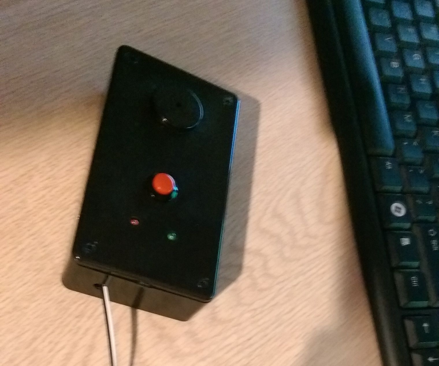

Basically a PIR sensor (like used in alarm systems) detects motion on the couch area and turns on a noise maker thus scaring the dogs off the couch.

Ok so I planned this out on paper first, and my first idea was to use a piezo speaker and a little vibration motor. First test run it just wasn't loud enough. So I had to rethink this part. I ended up designing something using an idea from a New Years Eve noise maker I've seen that is just a gear and a plastic reed that you swing around.
I happen to have a nice 3v DC motor around in the scrap pile So I used that. If you want to be able to use my design as is you can try to find one of these motors, they are common in CD Drives and can be found on Ebay (mitsumi m25e-4). Second lesson learned here was that while this motor runs well on 3v running it directly from the data pin on the Arduino did not give enough amps to have any strength, So I will show you how to use an NPN transistor to pull power directly from the source and trigger it with the pin instead.

Step 4: Design the Enclosure
Learned a few lessons here.
1) When designing parts to fit together don't forget to offset the size a little otherwise they won't go together.Main
2) Make sure that everything will fit. My first case everything in the lid hit something in the main part of the case.

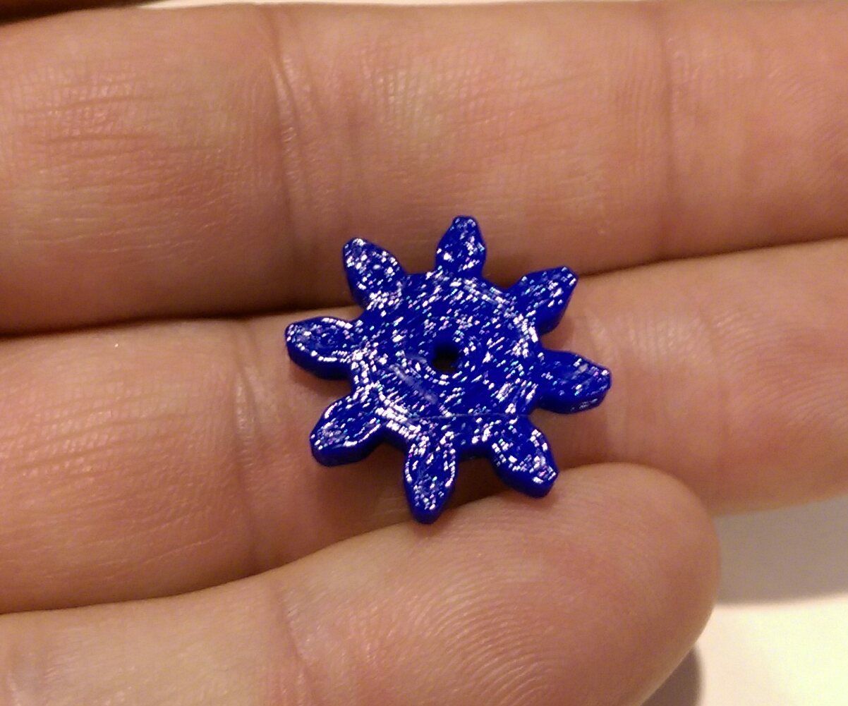

My gear is pushed onto the shaft of the motor. The Flapper arm is held on by a m3 screw and nut.
I won't go into designing in CAD but I did need to figure out how to make a gear to the size I needed.
Turns out that Inkscape the free SVG tool has a tool for that. Here is an Instrctable on Make your own gears. This is one of the areas that DS Mechanical let me down as I couldn't load the SVG so I used Tinkercad a free online tool, from that I exported as STL file and this I imported into DS Mechanical which does let you load STL files and even convert them back into solids to manipulate them like putting a hole in it for the motor shaft. DS also didn't do text so This too I did in TinkerCad as well and imported.
