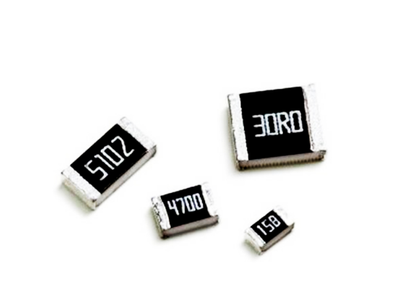

The resistance value of chip resistance is marked on the surface of resistance body just like the ordinary resistance.There are three nominal methods of resistance value but it is completely different with ordinary resistance.
Step 4: Number Nominal Method
1. Number Nominal Method(Frequently used for ordinary chip resistance)
Number Nominal Method is to mark 3 numbers on the surface of resistance body to show its resistance value. The first and second number are valid number, and the third number represents the quantity of “0” behind valid numbers. And the third number will not be an alphabet. For example, “472” is for “4700Ω”, “151” is for “150Ω”.
If it is decimals, then use “R” to represent decimal point for a number place. And the other two numbers are valid numbers.For example, “2R4”is for “2.4Ω”, “R15”is for “0.15Ω”.
