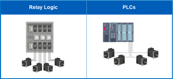

Step 2: Why PLC?
In early days before 1960’s control and automation tasks in industries were carried out via banks of relays. Each relay controller had inputs and outputs based on physical wiring. The old bank of relays was big in size and very complex. To change the operation, the physical wiring had to be changed which was very complex. Also faults finding was difficult and very time-consuming. To overcome the difficulties faced with relays, PLC was invented. It was introduced to meet the needs of the automotive manufacturing industries i.e., to provide flexible, rugged, and easily programmable controllers and as a replacement for relay systems. Now, they have been widely used in a variety of industries because they’re fast, easy to operate, and are easy to program. As compared to Relay systems, PLC units are more reliable, compact and required less maintenance.
Below is a differentiation between relay and PLC:
Relay
1. Has more wiring
2. Changes are difficult to make
3. Requires more power
4. Requires more maintenance
5. Difficult to expand
PLC
1. Has less wiring
2. Changes are easy to make
3. Requires less power
4. Requires less maintenance
5. Easy to expand
Considering all the factors above we can easily determine that PLC has successfully replaced Relays and is commonly used in many industries nowadays.

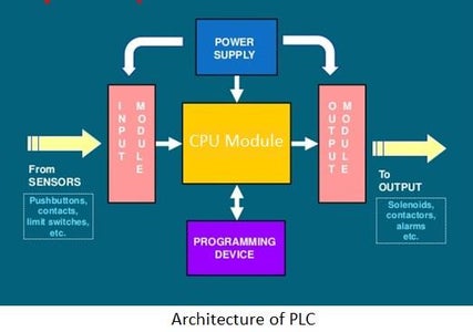

Step 3: PLC Architecture
PLC architecture is the overall design of the PLC system. All PLC have four basic and essential components, combination of all these components is considered as a full system. As you can see in the image Power supply, CPU Module, input/output modules and programming device are the four main components of PLC. Further we will see the components in detail.
1.CPU module: Firstly, processing of the data occurs in the CPU of PLC and then it executes the control program that is stored in memory to send output signals.
2.Power supply module: It is a crucial module in providing power to the attached components of PLC and attached devices. It receives AC power and converts it into DC power.
3.Programming device: Various operations and logic need to be controlled without which a PLC is dysfunctional. Programs of various PLC can be written through their respective software.
4.I/O modules: They send and receive data to and from external devices. These modules can either be in digital form or analog form.

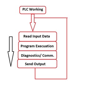

Step 4: PLC Process Pipeline
Components of PLC architecture work in coherence to ease the task of industrial automation. PLC captures data from the plant floor by monitoring inputs from the machines and devices that it is connected to. The CPU thereafter applies logic to the data, based on the input state. Logic is nothing but the user-created program representing the desired functioning for the process or task. The CPU after processing sends outputs or commands to the machines and devices connected to it.
