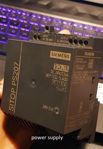

  2. Siemens power supply

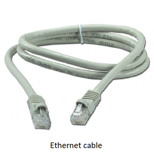

  3. Ethernet cable

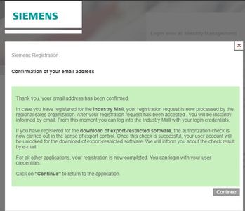

After you are done with all the registration steps you will receive a mail on your registered email account for conformation of your mail and registration. Go to the mail and click on the link for conformation of mail. Also conform your registration from another mail received. As shown in the image you will get a green color note after successful conformation of email and registration. Click continue for proceeding.

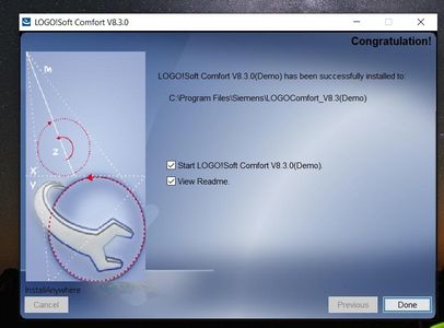

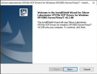

1.Download the zip file and run the setup.exe file that is suitable for your PC. According to your PC configuration Run the .exe file i.e., Win64, Win32, MacOSX, etc.
2.Next, you’ll need to extract after downloading then run the “Setup.exe” file.
3.Installation for LOGO! Soft Comfort will pop up, click ok and then accept the terms for installation.
4.It will ask the permission for the installation of Shield wizard, grant the permission.
5.Accept the terms and conditions that will pop up in the process.
6.It will automatically select the installation location. If not then assign it to the C drive of your PC.
7.Click “Finish” and on the next screen click “Ok”. This will install the software completely.

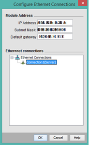

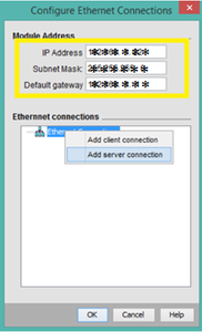

  7. Open Ethernet Connection from “Tools” tab located in Menu bar.

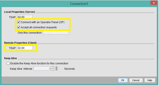

  8. Fill the required fields then Right-click on Ethernet Connections and press “Add server connection”.
  9. Now, double click the created connection and check the checkboxes of “Connect with an Operator Panel (OP)” and “Accept all connection requests”. Then set the TSAP to “02.00”.

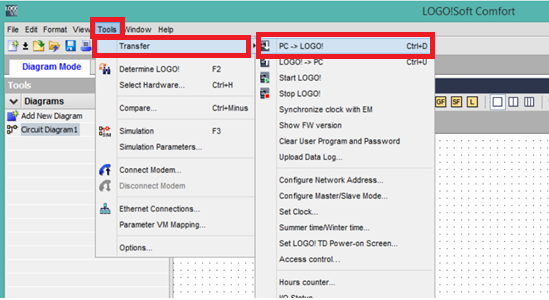

  11. Now transfer the newly created program to the PLC. Under the “Tools” tab from “Transfer” select “PC -> LOGO!”, or you can find the same option within the “Standard toolbar”.

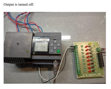

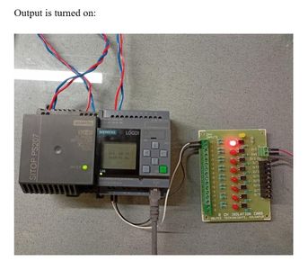

We will try this program using actual PLC. The connection that should be done in the software is as shown in the image. To change the time settings change the properties of the timer. The properties of the timer can be changed by double clicking the programming block.
Q. To turn the output (led) on-off for a period of 1 second.
Solution:
1. When the circuit it switched on, the timer T1 starts. T1 is connected in series with NC of timer T2
2. It runs for 1 second and for the entire duration keeps the output turned on.
3. This output activates the second timer T2 for a set duration of 1 second.
4. After the period of 1 second the cycle repeats itself.

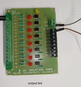

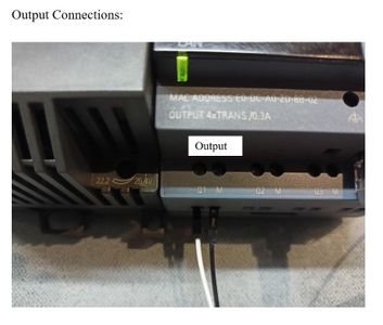

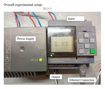

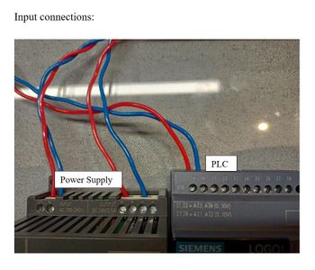

Step 12: Physical Connections
Circuit Diagram is shown in the first image. Input and output connections are also shown in the image. The overall set up after connection of input, output, power supply and ethernet connection is as shown in the image. Make sure that the physical connection are made properly, as the current and voltages level are high, wrong connections might damage your equipment
