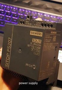

  1. Siemens LOGO PLC
  2. Siemens power supply
  3. Ethernet cable

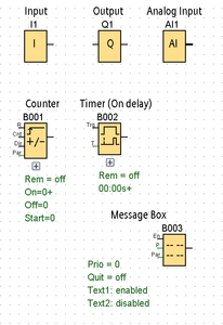

To program in any language, its functions and features need to be understood. In PLC programming, elements depicting functions are used. The following elements are some of the basic blocks:
  1. Normally open
  2. Normally closed
  3. Output / Relay coil
  4. Timer On-Delay
  5. Message Texts
  6. Counter

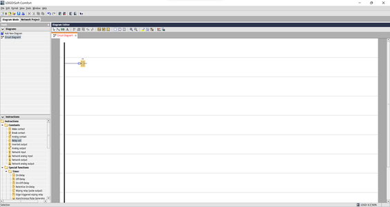

Step 3: Programming Interaface
Here, I've preferred Ladder Logic.

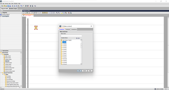

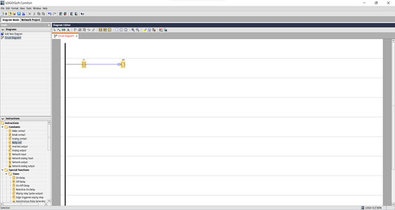

  1. You need to drag and drop elements from “Instruction” onto the “Empty sheet” and make connections respective to your program.
  2. At this stage keep the highlighted name itself and then click “OK”.
  3. Make connections with the Black Wire (“Left power bus”) by clicking and dragging the “Left power bus” towards the left input to make a connection.
  4. Similarly drag another instruction and make the connection.

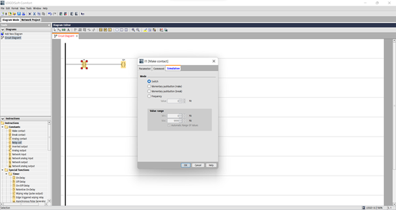

  5. To change the properties of the switch, you need to double-click that. This will pop up a dialogue box where you can change the properties. Click “Ok” after properties are changed.
  6. You can then upload the program to PLC or simulate it within the software.

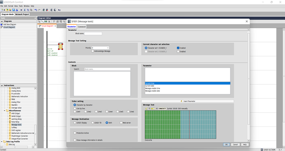

“Message Text” block is used to display the text on the display. Its “En” connection needs to be connected to “High / 1” to be able to display text on the screen.
Step 5: Customizing the Text on PLC
To display custom text, you need to enter the text in the properties of the block. Within the properties, get to the “Message Text” area. You can write within the green area and can enter symbols from the given options, click “Ok” once completed.

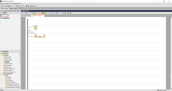

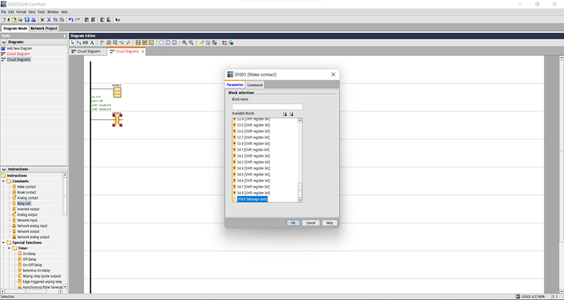

Step 6: Configuring the Connection of the Logic
To configure the connections of the message block, drag an “NO” connection and double click to change its property. Scroll down and select “Message texts”. Now connect the other connection to an output. This part is crucial for displaying text on the PLC display.

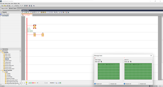

Step 7: As Observed During Simulation on PLC
To perform simulation on PLC, select the simulation option and then click on the "Play" option. This will simulate the Ladder Logic and a Pop-Up screen will appear displaying the custom text.

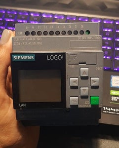

Step 8: As Observed on Actual PLC
Make the required connections on the PLC, make sure they are correct. Then send the ladder logic to PLC and select "RUN" The output will be similar to the photo.
