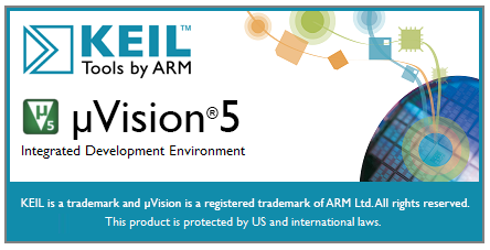

Step 2: Getting, Installing and Setting Up Keil for ARM
Keil (uVision5):
- Open this MDK-ARM Keil in new Tab.
- Fill out the form with your details and click submit. This will take you to the keil arm download page.
- Click on MDKxxx.exe. This will start downloading the program.
Installing keil uVision 5 (Keil for ARM):
- Start the downloaded Setup.
- Click Next.
- Click on check box next to "I agree to all...". and Click Next.
- Select where to install. When selected, click Next.
- Enter your details and click Next.
- Now, installation will start, wait for it.
- After some time, it will complete installation. Un-check the "show release notes" checkbox and click "Finish".
Installing Packages:
- Start Keil as administator.
- Click on Pack Installer in the main window and new windows will open.
- Click on the Pack >> Check for the Updates. This will check for the updates from the internet.
- Select the STMicroelectronics in the Devices Tab.
- Install/Update following components. (In case of STMF1, chose for your board accordingly)
- Device Specific:
- Keil::STM32F1xx_DFP
- Keil::STM32NUCLEO_BSP
- Generic:
- ARM::CMSIS
- ARM::CMSIS-Driver_Validation
- ARM::CMSIS-RTOS_Validation
- Keil::ARM_Compiler
- Keil::MDK-Middleware
- Device Specific:
- Close the Pack Installer and Exit Keil.
