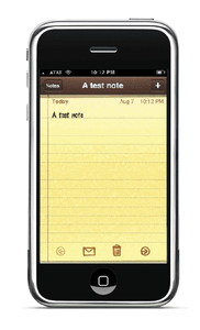

Introduction: Getting Notes Off Your IPhone (Jailbroken)
Things you will need:
1. A jail Broken iPhone
2. A Computer
3. iFunBox
4. Spare Time
If you do not have a jailbroken phone there are many instruction articles out there just google GreenP0ision or RedSn0w. If you keep having trouble unlocking it, it may be due to your modem Firmware being one of those tricky bastards that wont unlock 06.15.00 works fine but if you have an older 3G with an older version of firmware you may have to upgrade it first before you can unlock your phone.If your phone is not jailbroken try here for all your jailbreaking needs.
Getting Information:
Download ifunbox from here
I find it a much easier way to download and upload data to your phone than using the open ssh method plus it doesn’t crash all the time.
Expand the ‘Raw File System’ tab and navigate to: //User/Library/Notes
Copy the notes.sqlite file to your computer by just dragging and dropping
Rename the new file notes.html and all your notes should come up in your default internet browser.
All your notes should all be right there just copy and paste into your word document or whatever it is.
