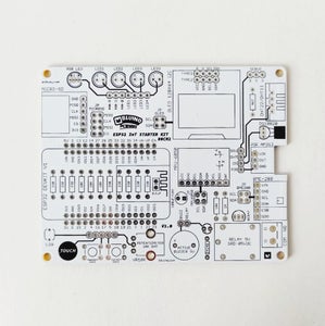

  • 1 x PCB ESP32 IoT Starter Kit (PCBWay)

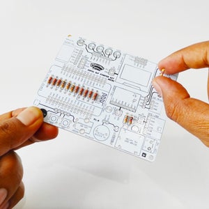

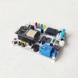

Step 4: Place All of Components
Attach the trough hole components on the PCB following the pictures and symbols on the PCB, for details you can follow step by step in the video.

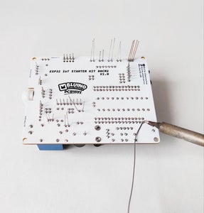

Step 5: Soldering
Solder all the component legs on the back of the PCB, for details you can follow step by step in the video.

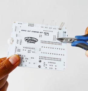

Step 6: Cutting Wire
After finish solder, cut all the long legs of the component wire.

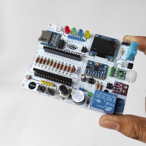

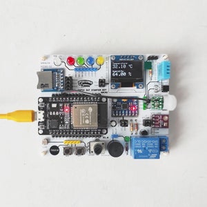

Step 7: Attach ESP32 DEVKIT V1 Module 30 Pin
Attach the ESP32 module into the female header socket 2 x 15 pin.
Step 8: Hardware Is Ready
Now, time to begin learn basic IoT use ESP32 IoT Starter Kit boards, is very easy just following the more than 110 tutorial on randomnerdtutorials.com/projects-esp32.

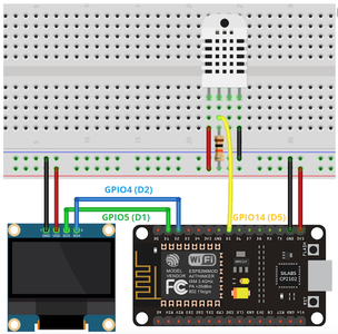

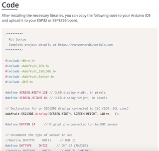

Step 9: First Test Hardware
On randomtnerdtutorial projects-esp32 under Displays topic select the tutorial OLED Temperature. This tutorial will use DHT11 and OLED display on Starter Kit board, you will need one wire jumper female to female 20cm to connecting GPIO14 to DHT11 follow the schematics. Upload sample sketch to ESP32 board then see whats happen.
Step 10: Enjoy Tutorial for ESP32
