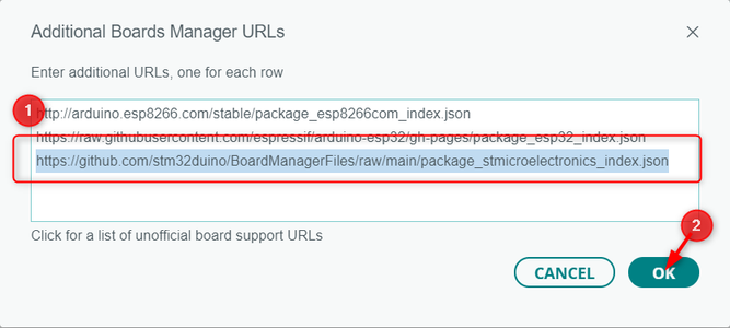

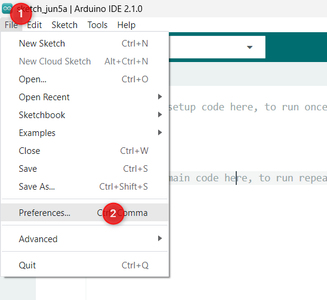

Step 1: Add Board Support URLs
  1. Click File -> preference
  2. In the "Additional Board Manager URLs" add this link: https://github.com/stm32duino/BoardManagerFiles/raw/main/package_stmicroelectronics_index.json
  3. click OK

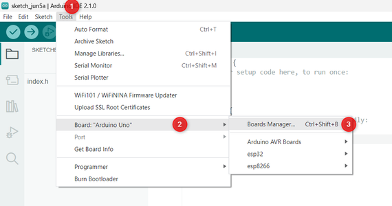

Step 2: Install STM32 Based MCU
  1. Go to Tools -> Boards -> Boards Manager
  2. Search for "stm32duino"
  3. Click Install on the "STM32 Based MCU Boards"
  4. Wait for the instalation process to complete

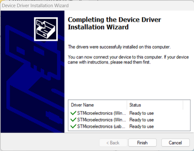

Step 3: Install Driver
We will install STM32CubeProg to solve driver problems.
  1. First, go to this link
  2. Download STM32CubeProg. You will need to log in, or you can download it as a guest. The download link will be sent to your email. Make sure you use the same browser to open the link as the one you used to request it previously.
  3. Extract the file and install STM32CubeProg by following the steps until the instalation is complete
