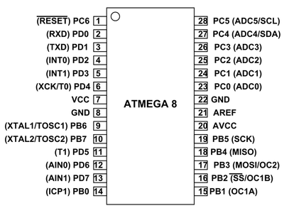

The ATmega8 provides the following features: 8 Kbytes of In-System Programmable Flash with Read-While-Write capabilities, 512 bytes of EEPROM, 1 Kbyte of SRAM, 23 general purpose I/O lines, 32 general purpose working registers, three flexible Timer/Counters with compare modes, internal and external interrupts.
Step 3: Basic Circuit of Atmega8:
This is the minimal circuit of atmega8, We need a 16MHz crystal with 22pf capacitor on the clock pins. 10k resistor between reset and +5v pin.
And then power connections, atmega8 is rated 3.7v -5.5volts.

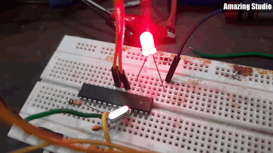

I used to upload blink program, when working first time with any new microcontroller. Because this is easy, understandable and visible to user, and a easy way to check bootloader operation.
// the setup function runs once when you press reset or power the board
void setup() {
  // initialize digital pin LED_BUILTIN as an output.
  pinMode(LED_BUILTIN, OUTPUT);
// the loop function runs over and over again forever
void loop() {
  digitalWrite(LED_BUILTIN, HIGH);   // turn the LED on (HIGH is the voltage level)
  delay(1000);                       // wait for a second
  digitalWrite(LED_BUILTIN, LOW);    // turn the LED off by making the voltage LOW

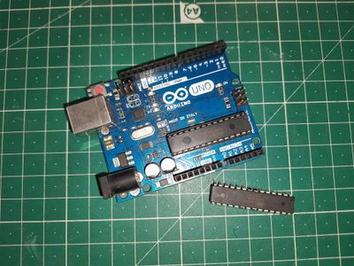

Because of pin compatibility and internal architecture, Atmega8 can be used in Arduino Uno boards without any change. But keep the flash and interrupts limitations in mind
I designed some Arduino Uno clone boards, I think they are perfect for atmega8. You can see full article on How to make Arduino Uno clone boards from here.
