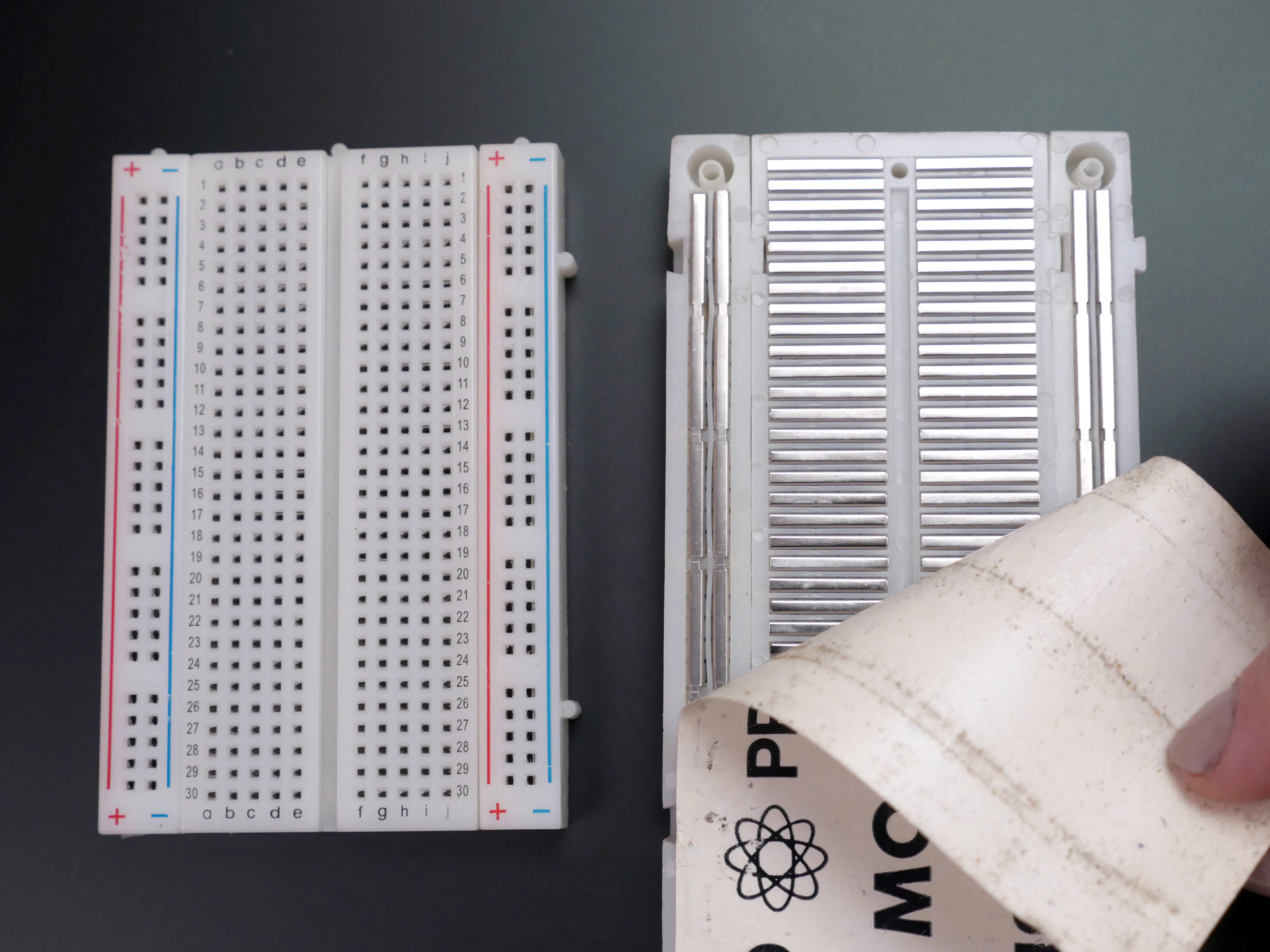

Step 2: Solderless Breadboards
Solderless breadboards are for prototyping circuits quickly and easily. You can think of it as akin to a dry-erase board, great for speedy brainstorming and experimentation. Breadboards allow you to connect components using multi-port metal sockets. The conductive parts of the breadboard allow electrons to flow between the things you plug into it.
On the right you can see inside a breadboard to observe how these sockets are connected. Two long rails run down each side, marked with red and blue lines on the front. These long connectors are typically used for power and ground connections, which are used quite often. The small horizontal rows that comprise the middle of the board are for plugging in wires and components. Notice the divider down the middle of the board-- this exists to provide chips a place to straddle, providing independent access to each of its pins.
It takes some practice to get the hang of using a solderless breadboard, mainly because it's hard to remember which spots are connected to which other spots. You may find yourself referring back to the photo of the inside of the breadboard frequently; that's perfectly normal!

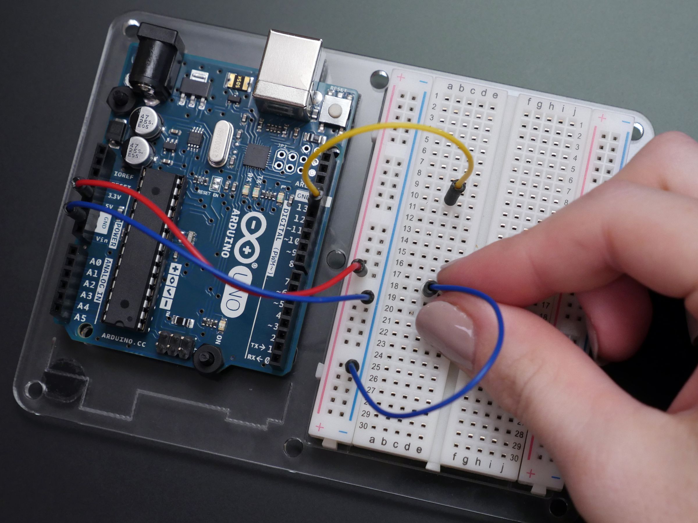

The first circuit we'll build on the solderless breadboard connects a red LED to the Arduino Uno board. Let's start out slowly, with one wire connection at a time. Follow along with the same colored wires to make it easier on us both. Double check that your USB cable is disconnected before doing any wiring to your board. Grab a red wire and plug one end into the pin marked 5V on the Arduino board. Plug the other end of the red wire into the breadboard rail marked with a red line— this will be your power bus.
Similarly, grab a blue wire and plug it into one of the pins marked GND, right next to the red wire. There are three ground pins on an Arduino Uno, and they're all wired to the same ground as the chip and the rest of the board, so it doesn't matter which one you choose. Plug the other end of your blue wire to the blue ground bus on your breadboard. This is a common configuration you will use again and again, and should be your go-to setup for new breadboards, even if you aren't using both buses immediately. Circuits in this lesson will connect to the ground bus, and in the next lesson you'll use some components that will connect to the 5V power bus.
Next, plug a yellow wire into Arduino pin 13. Plug the other end into any horizontal row on your breadboard (row 10 shown above). For this first circuit, all of your connections should be composed on the half of the breadboard closest to the Arduino board.
Connect another blue wire from any pin on your ground rail to another horizontal row on your breadboard (row 18 shown above).
Now grab a 1K resistor (stripes are brown-black-red-gold), and plug one of its wire leads (doesn't matter which) into the same row as the blue wire. Resistors all look similar, except for the stripes used to indicate their value.
Plug the other end into a row right next to the yellow wire.
Now grab a red LED (light emitting diode). See how one of its wire leads is longer than the other? That's the positive lead (anode), and the shorter lead is negative (cathode). In the circuit we're building, positive charge comes from the Arduino pin and goes through the LED and resistor to ground, so you should connect the positive (longer) lead to the yellow wire and the negative (shorter) lead to the resistor. A resistor helps limit the current going through an LED, which doesn't do a great job of limiting itself.
Another way to guess the polarity of an LED is by looking inside the lens at the anvil (bigger piece of metal) and post (smaller piece of metal). The anvil is usually the cathode, but as you can see in the above video, not all LEDs observe the same polarity conventions. The only way to be totally certain of its polarity is to test it. To learn more in-depth about resistors and LEDs, check out the LEDs lesson in the Instructables LEDs & Lighting Class.
Plug in your USB cable and the LED should immediately start to blink! It's programmed to blink whatever's connected to pin 13. That includes the onboard LED you saw in your software setup as well as the one you just wired up.
If your LED isn't blinking, unplug your USB cable, then reverse your LED and replug your USB; maybe the LED was just plugged in backwards (which won't damage it, but won't light it up, either). Or perhaps one of your other wires or resistor aren't connected correctly. Double check your connections against the diagram of the circuit:

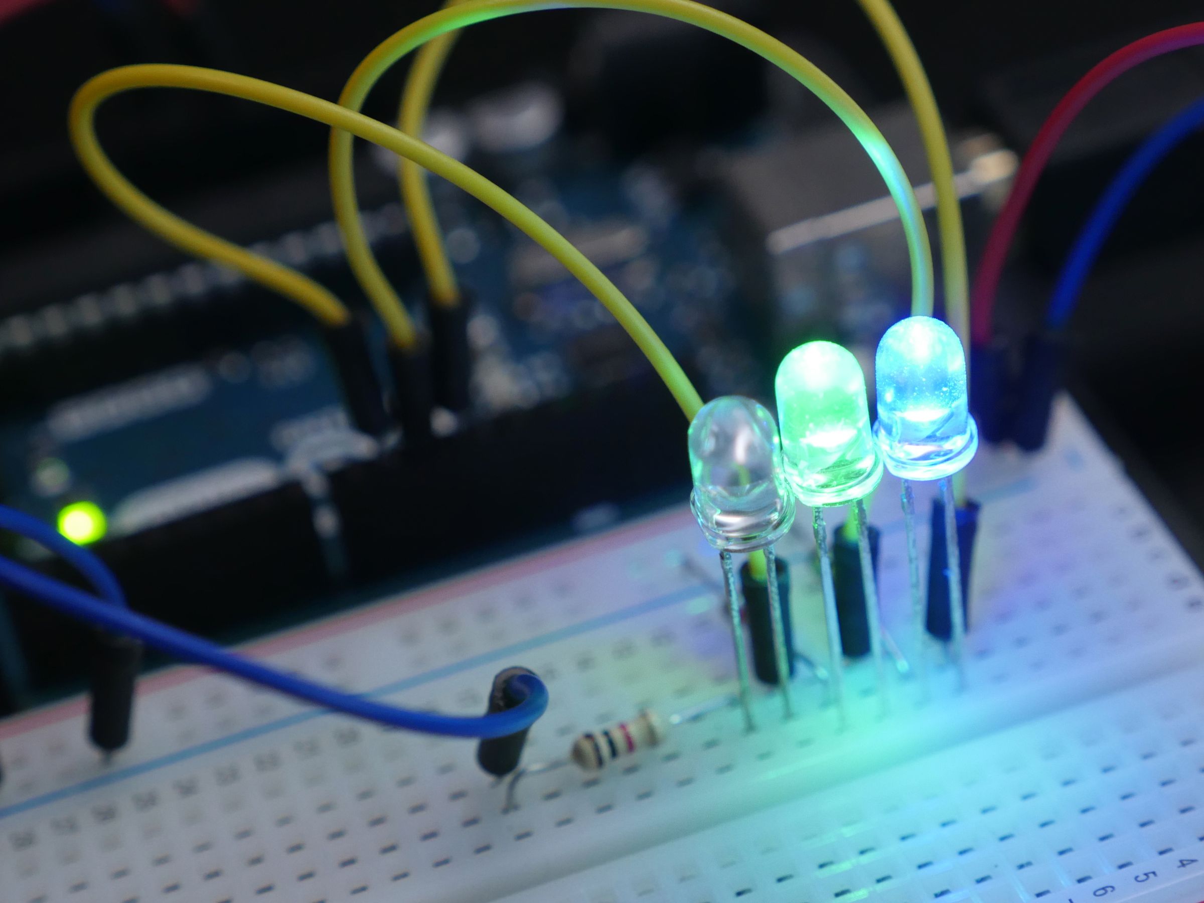

Additive (light-based) color has three primary colors: red, green, and blue. Simultaneously controlling the brightness of one LED of each of these colors can create almost any color of light. Color changing LEDs like those used in the final project work the same way, but the LEDs are all together in a very small package called an RGB LED. Let's build our own RGB LED from three 5mm LEDs in your kits. In the Adafruit kit recommended for this class, these three LEDs have clear lenses, so we'll have to plug them in to determine which LED is which. LEDs with clear lenses can be any color! If you're using a different kit, just find one red, one green, and one blue LED (clear or colored lens). Unplug your USB cable and swap out the red LED for one of the clear-lens LEDs, then plug the USB back in.
What color is the LED? If you find the red one on the first try, set it aside and repeat the process to determine the color of the the other two LEDs.
Wire up the other two LEDs with 1K resistors to pins 10 and 11, as shown in the diagram. Download and open the code from the Tinkercad Circuits module or copy and paste it into a new empty Arduino sketch. Upload it to your Arduino Uno board and see if you can match up the lines of code to the activity you see in the LEDs, as we have done together so far.
The unfamiliar part of this code is the function setColor();. It's a custom function, defined below the loop() has ended.
