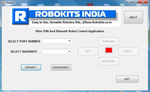

Step 2: Making of Visual Basic Form
Make Form as Shown in Image with the help of
2 buttons,
Label,
2 Combo box,
1 Serial Port

Step 4: Modify Form and Visual Basic 2008 Program to Control Robokits Wireless 865-869 MHz Robot
Part to be required
Robokits RF 865 Mhz Robot
Cp2102 USB to Uart Module
http://robokits.co.in/development-boards/interface...

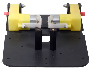

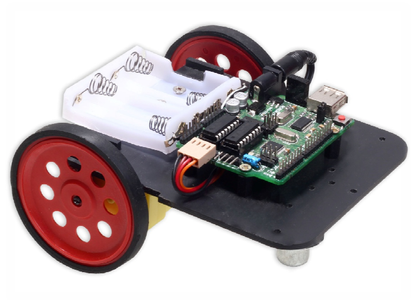

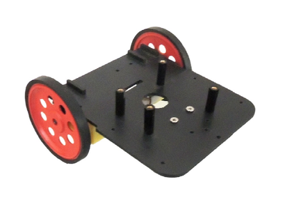

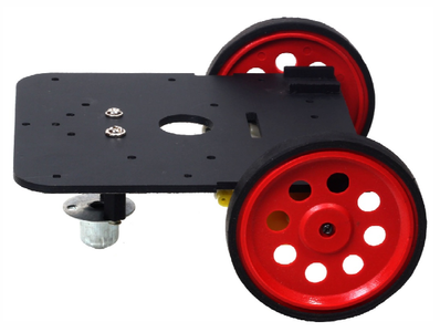

Step 5: Assembling Robokits WIRELESS RF SERIAL LINK 865-869 MHZ ROBOT.
Step 6: Upload Program to Robokits Roboduino Board
