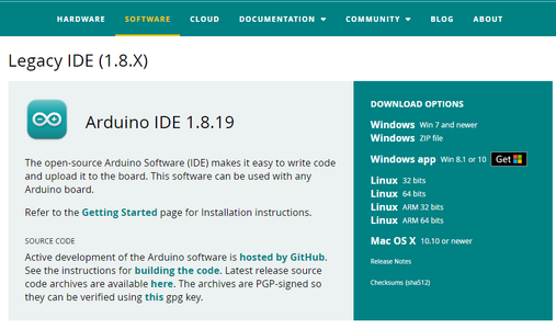

Step 1: Download the Arduino IDE
IDE - Integrated development environment, or an application, that we will use to write code and upload code.
I don't recommend you to download the Arduino IDE 2.x versions. There are still some bugs and some features that are not supported yet for the ESP32. I recommend to download the 1.8.19 version of Arduino IDE because it works properly with ESP32.
  • To see the Arduino IDE page click - here.
  • Scroll down and find the 1.8.19 version.
  • Select your operating system and download.

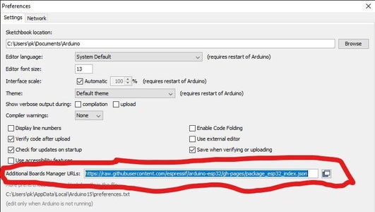

  • Open the Arduino IDE.
  • Navigate to the File > Preferences, paste the "https://raw.githubusercontent.com/espressif/arduino-esp32/gh-pages/package_esp32_index.json" link into the Additional Boards Manager URLs text field.

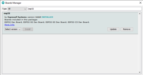

  • Navigate to the Tools > Board > Boards Manager, find the esp32 and click install.
  • Then you'll need to go to the Tools > Boards, and choose your esp32 board.

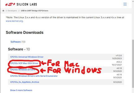

Step 4: Download and Install Driver CP210x for ESP32
  • Then you will need go to the page with CP210x Driver.
  • Page with CP210x Driver for ESP32 - here.
  • Scroll down until you find the CP210x "VCP Mac OSX Driver" - for MacOS or CP210x "Windows Drivers" - for Windows.
  • Download;
  • After downloading you will need to go to the Download folder;
  • Find CP210x driver .zip;
  • Unpack the .zip file, go to the unpacked folder and Install the x86 driver .exe.

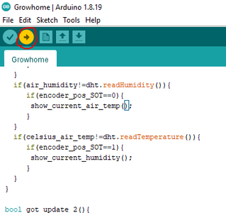

Step 5: Upload an Example
#include "WiFi.h"
const char* ssid = "yourNetworkName"; //choose your wireless ssid
const char* password = "yourNetworkPass"; //put your wireless password here.
void setup() {
 Serial.begin(115200);
 WiFi.begin(ssid, password);
 while (WiFi.status() != WL_CONNECTED) {
  delay(500);
  Serial.println("Connecting to WiFi..");
 Serial.println("Connected to the WiFi network");
 Serial.println("IP address: ");
 Serial.println(WiFi.localIP()); //show ip address when connected on serial monitor.
void loop() {}
  • Create a new Sketch;
  • Change the SSID and Password in the sketch;
  • Navigate to Tools > Board: > ESP32 Arduino > 'select you board'
  • Click the upload button;
  • When you see "Connecting.." message, hold BOOT button on your board until your Sketch will be uploaded;
  • Check the Serial Monitor;
If you saw connected message, everything worked properly.
