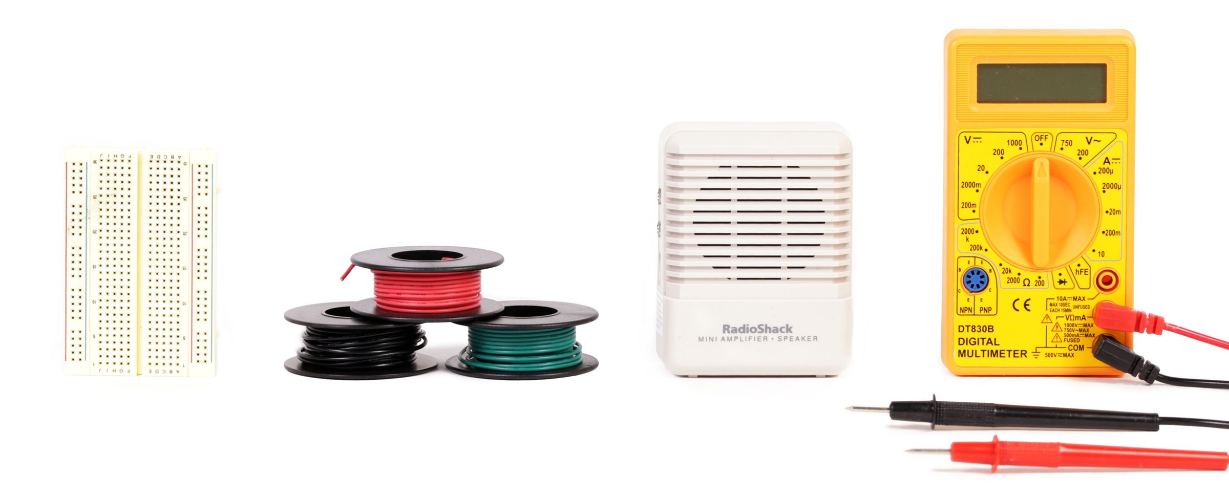

To begin, it is advisable to get a basic electronics kit which includes resistors, capacitors, diodes, and LEDs (amongst other things). There are no hobby kits which are perfect. They will always be missing that one last thing you need. However, the one I linked to includes a little bit of everything, and is a good place to start. You will be using lots of different components throughout the course, and having this on hand will come in useful for experimenting and trying things out.
You should also pick up solid and stranded wire, a few breadboards, a multimeter, and a test amp, all of which, I am about to explain further.

Solid core wire has a single piece of metal inside the insulation. This type of wire is good for electronic circuit boards or connecting components together on a breadboard because it can easily plug into the board's sockets. Solid wire keeps its shape when bent, but it's also more prone to break if flexed too often.
Stranded core wire consists of thin metal strands bunched together. This wire is better for connecting to components which are handled a lot or move around (such as connecting to motors on a robot arm). This type of wire does not easily plug into a microcontroller's sockets, as the strands spread apart and fray, making it annoying for prototyping. However, it is very flexible and can be bent a lot without snapping.

Breadboard are meant to make quick non-permanent connections between electronic components. They are covered in tiny socket holes which are connected in rows. The board itself is broken into four sections. There are two inner sections full of short horizontal rows, and two outer sections with longer vertical rows.
The inner sections are typically used for connecting components, and the outer sections are typically used as power bus lines. In other words, you can connect a battery to one of the outer lines and then power components on the inner section by connecting a wire to this section.
In the above graphic you can visually get a sense of how the rows on breadboards are electrically connected. The two inner sections have short horizontal rows repeated down the board. The two outer sections each have two long vertical rows. These are marked in red and blue and are meant to signify a row for power (red) and a row for ground (blue). Not all breadboards are marked with lines like this, but they are all laid out the same way.
To use a breadboard to prototype circuits, you simply insert components or wire into the appropriate sockets to connect them together.
On account of their ease of use for circuit building, it is best to have 2 or 3 breadboards on hand.

A multimeter is a tool used for a wide range of electronics related measurements. Or you could say they could meter multiple measurements... multi-meter... painfully obvious - right?
A typical multimeter will measure voltage, current, resistance, and continuity. More advanced multimeters will also measure a host of other things that are not relevant to get into at this junction.
To set up the multimeter, plug the black probe into the ground / common port. Plug the red probe into the voltage terminal. It's now all set up.
Step 8: Test Amp
A test amp is particularly useful when experimenting with components and producing an audible output. As you begin to learn electronics, you will be amazed how many circuits can make noise, and how frequently this device will prove useful.
The reason this particular mini amplifier comes in so useful is that it both has an input for audio, and an amplified output for driving external speakers.

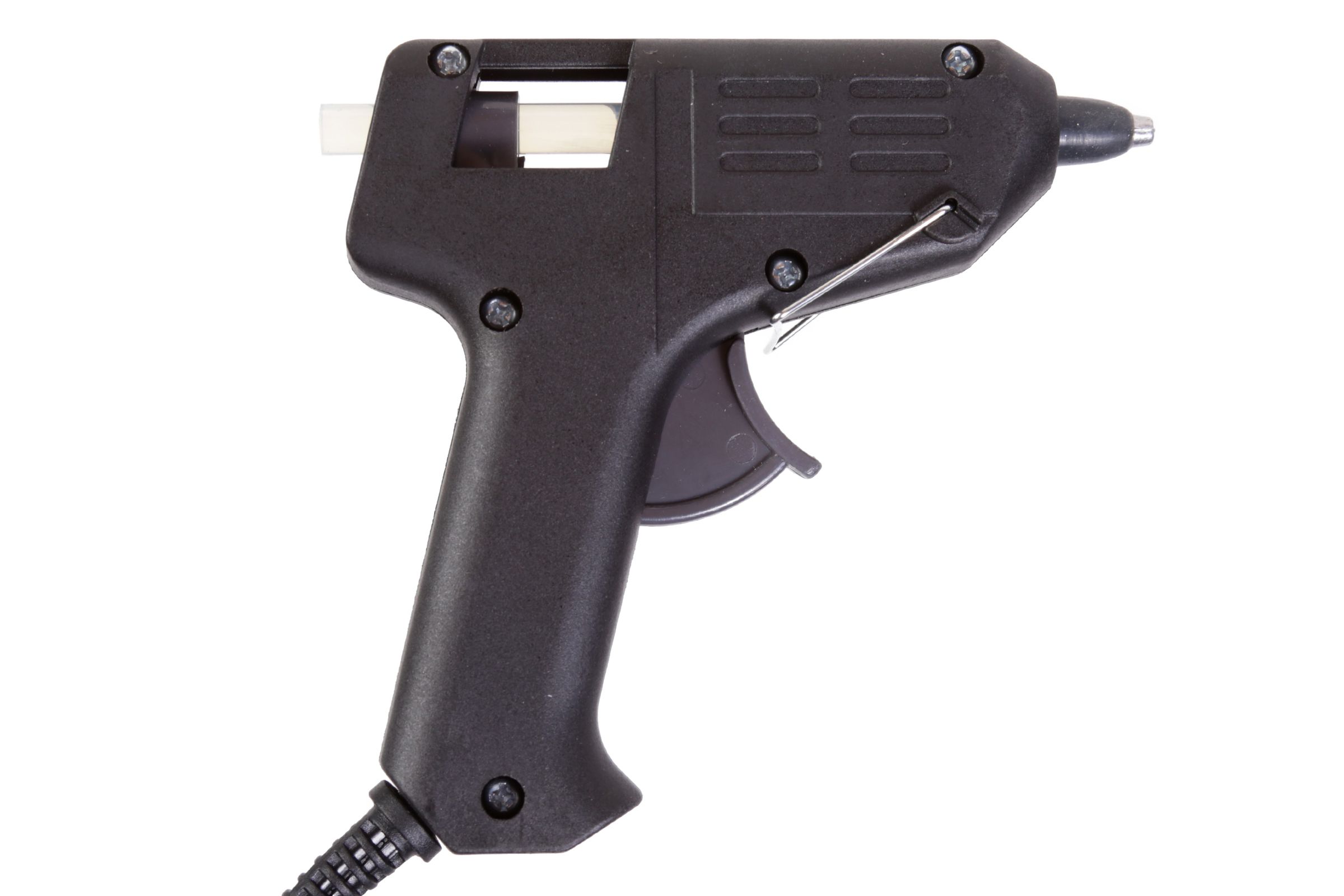

Less functional than zip ties, hot glue guns are a quick and dirty way to attach things together. These come in particularly handy when you need to quickly hold an electronic component in place inside of an enclosure and don't feel like figuring out a way to mechanically fasten it.

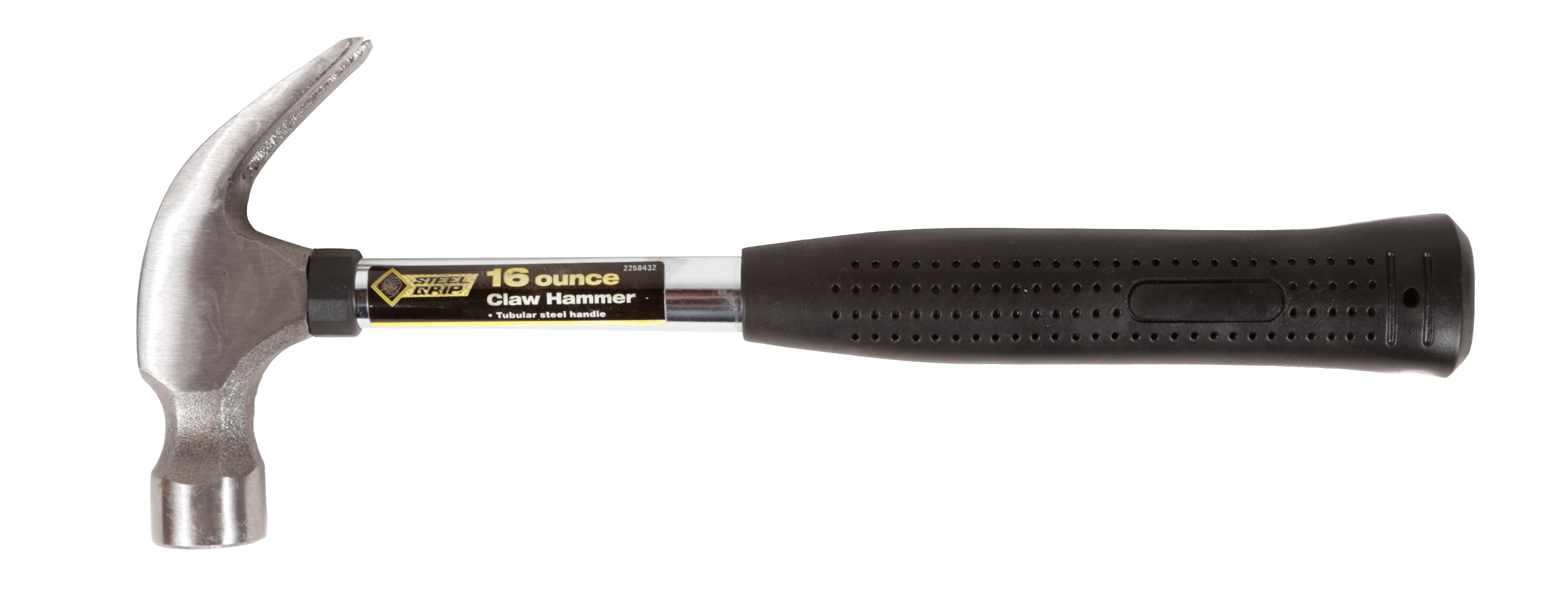

When all else fails, smash things.
We are only using one smashing tool - the trusty hammer.
On occasion we will need to smash things. It is unavoidable.
