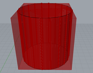

For initial testing, I picked up the Grasshopper file provided by the Prof. and slightly modified it to slice a cylinder. The above images shows how the Cylinder would get sliced in Rhino, and the end result worn by my "model friend" Subra (who is also taking the course).
The number of horizontal lines determine the curvature of the cylinder, more lines would imply smoother curve, but longer printing time. A bounding box is created around the cylinder. Then the bounding box is subdivided into a series of rectangles along equal intervals along the z-axis. The rectangles are then used to slice our original brep

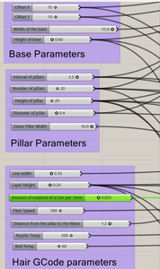

For the length one, I increased the number of pillars to 20 and changed the interval between pillars to 3.5mm. So, the overall length of the fabric came out to around 20 * 3.5, which is around 7cm. I also made couple of changes to the base for overall support and in the hope that it would break off easily. I changed the width of the base to 15mm and height of base to 0.6mm. And I also changed 'Amount of material of a hair per 1mm' to 0.025 to see how that varies from the initial fabric. Lastly, as per my filament I changed the Nozzle temp to 200C and Bed temp to 60C.
It took around 1hr 10 mins to build the structure and above has the image with scale in respect to the initial fabric.
