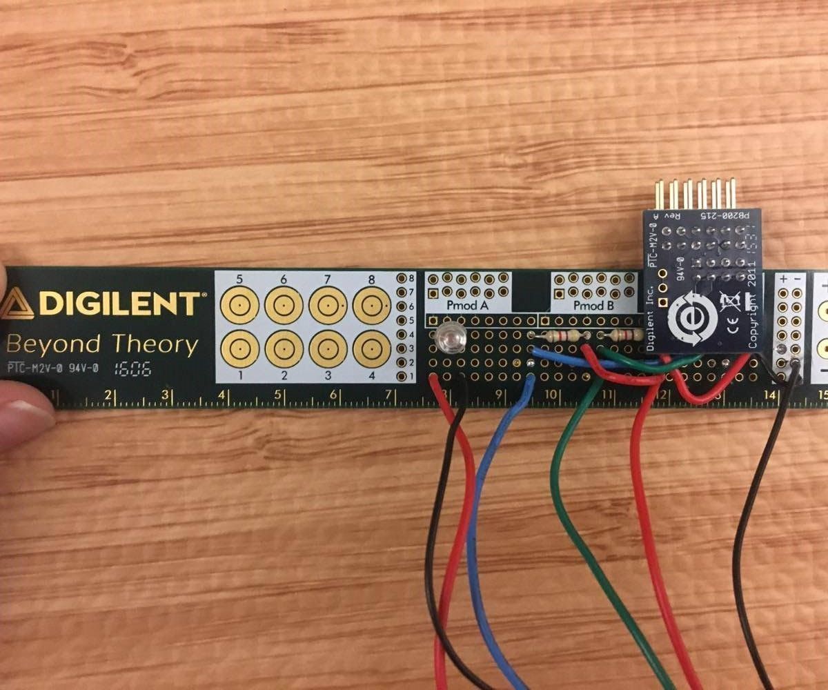

Blank VI's are great for a simple start. For example, if you're trying to blink an LED using the chipKIT WF32, a blank VI will work just fine.
