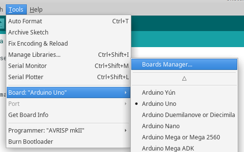

Open the board manager in Arduino IDE and start typing in the search line something like “MH-ET”. When you find the package, click “Install”. Wait until the installation finishes and close the dialog.
⚠️DO NOT CONNECT THE BOARD YET!
Step 3: Selecting the Board
Now select MH-ET LIVE Tiny88 in the boards list.

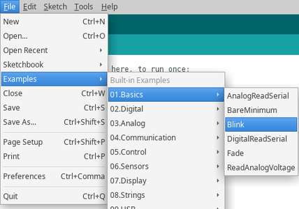

Step 4: Uploading the Blink Sketch
Open the Blink example from File menu. Click the “Upload” button and wait until you see the message that asks you to connect the board to a USB port:
Running Digispark Uploader...
Plug in device now... (will timeout in 60 seconds)
Do as it says. If you are lucky enough, that’s the final step. However if you see the following warning message, read the next step.
