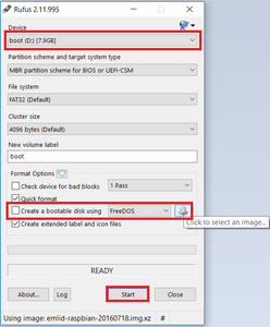

Then we should burn downloaded firmware on the SD-card. As I've already noticed, I am using Windows 10, so I will write firmware image using free Rufus Utility (download here). If you already have software for writing images you can use yours, however the successful result is not guaranteed (for instance Win32DiskImager doesn't properly work with Navios image).
To burn the image:
a. Run Rufus with administrator rights
b. Make sure your selected the right SD-card that should be burnt

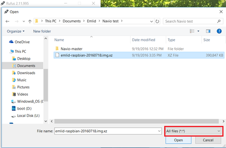

c. Tick "Create bootable disc" and select correct firmware (while selecting make sure you are searching through All files)
d. Push Start and agree with all warnings. After few minutes it will be done.

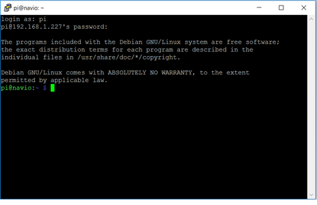

2. Connecting and Login
In Putty type in yours RPi2 IP-adress and select SSH for connection type, click open. In console login request will appear. For RPi2:
login: pi
password: raspberry
After that you will find yourself at pi@navio.

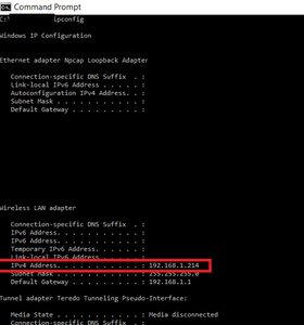

6. Finding our PCs IP address
To start the example on Navio+ we should figure out our PCs IP address so Navio+ will know where to send data. To find your PCs IP start Command prompt and type "ipconfig". There you'll see your computers IP address.
