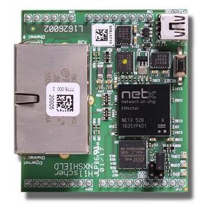

NSHIELD 52-RE is an extension board for development and evaluation purposes providing Real-Time Ethernet (RTE) connectivity for Arduino™-compatible host devices. Due to its Arduino™ header footprint, the netSHIELD can be easily plugged onto your development/evaluation board (i. e. the host device), enabling your application to communicate in industrial RTE networks like PROFINET, EtherNet/IP and EtherCAT without any further hardware development efforts. The netX SoC on the netSHIELD thus serves as “companion chip” for the microcontroller (MUC) of your host device.

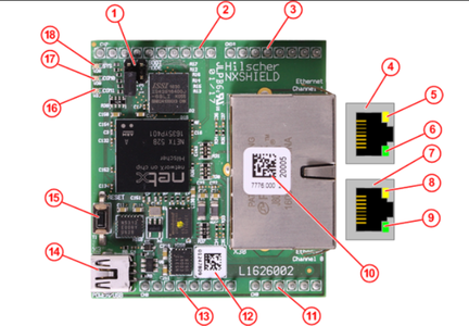

Step 1: Hardware Description
1. Boot mode jumper
2. CN7 - Arduino-compatible male pin header connector to host (pins are on the underside)
3. CN10 - Arduino-compatible male pin header connector to host (pins are on the underside)
4. Ethernet channel/port 1 connector (RJ45 jack)
5. Activity (RX/TX) LED channel/port 1
6. Link LED channel/port 1
7. Ethernet channel/port 0 connector (RJ45 jack)
8. Activity (RX/TX) LED channel/port 0
9. Link LED channel/port 0
10. Matrix label
11. CN9 - Arduino-compatible male pin header connector to host (pins are on the underside)
12. AOI (automated optical inspection) label
13. CN8 - Arduino-compatible male pin header connector to host (pins are on the underside)
14. Mini-B USB socket
15. Power-on reset push-button
16. COM1 - communication status LED
17. COM0 - communication status LED
18. SYS - system status LED
