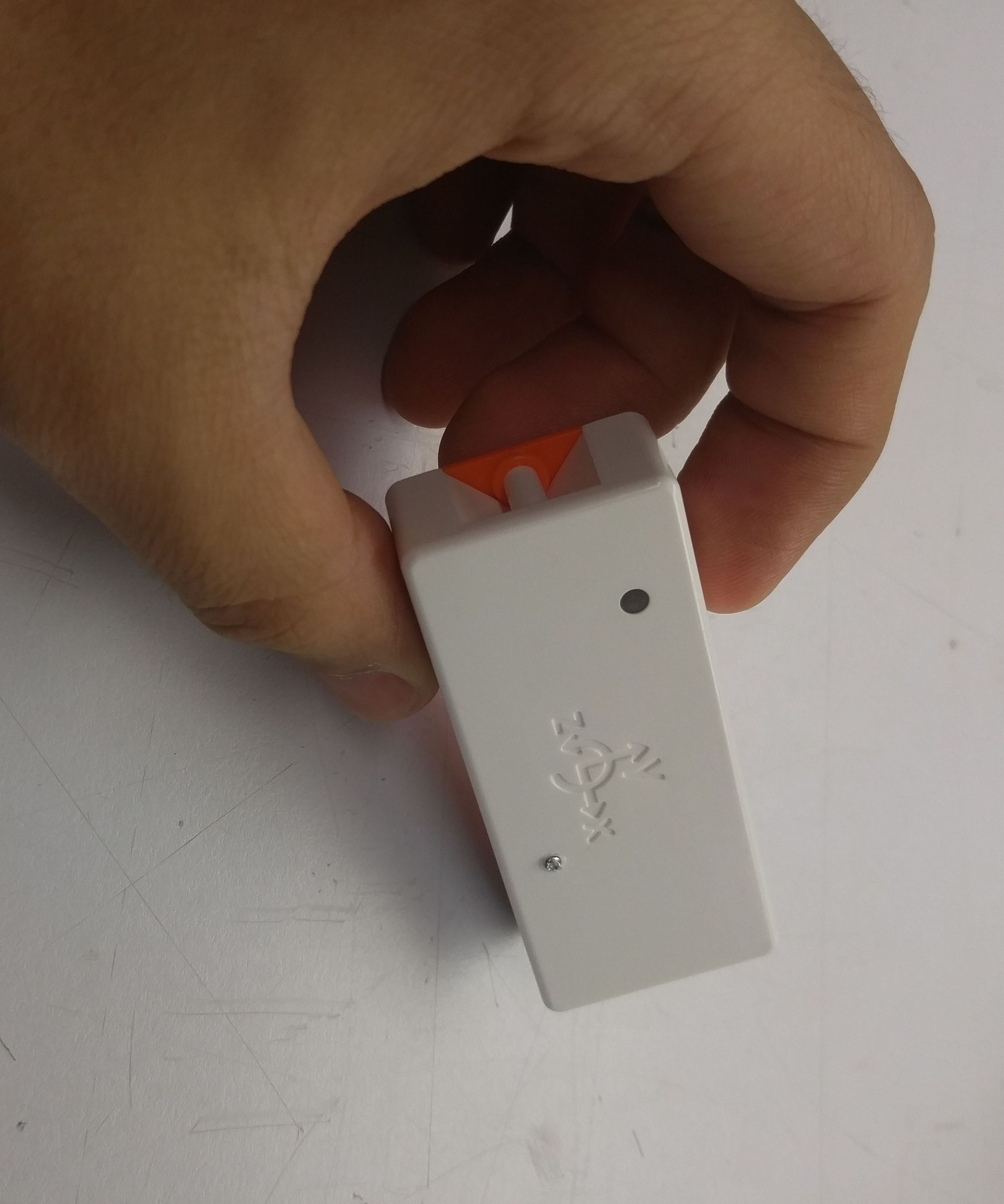

To connect the PocketLab sensor to your Windows device you will have to go through an initial setup like you would setup a Bluetooth mouse or speaker. You only have to do this once per PocketLab sensor and Windows device. After the initial setup, the PocketLab sensor can connect directly through the PocketLab app.
First, make sure your Windows 10 version is up to date, as the PocketLab app works best with the latest version of Windows 10. Then download the free PocketLab app from the Windows Store. After installations is complete, go to Settings >> Devices >> Bluetooth and turn Bluetooth ON. Press the top button on the PocketLab sensor. The sensor will flash red and green and a new Bluetooth device should appear in the device list with the serial number: "MS-PL-HW10-FW10-0001" and the message "Ready to Pair". Click on the Bluetooth device and press the Pair button. When prompted, enter the passcode "0000" and then press Next to pair to the PocketLab sensor. You can now disconnect the PocketLab sensor from your windows device by pressing the top button. Finally, go to your applications from the Start menu and click on the PocketLab icon to launch the app. The first time you open the app you will need to agree to allow access privileges in order to connect to the Bluetooth hardware and PocketLab sensor.
