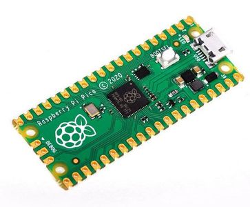

As you may know Raspberry Pi Pico is the first microcontroller from Raspberry Pi foundation and I don't want to talk about the Pico in details here. More information is available in Raspberry Pi website.
Nevertheless, the highlighted feature about this lovely microcontroller is we can program it with micropython and believe me, once you learn micropython and write your first code, you would never drop it!

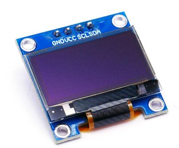

SSD1306 OLED is a tiny useful display that communicates through I2C.It is available in two in the store:
64*128 pixels and 32*128.

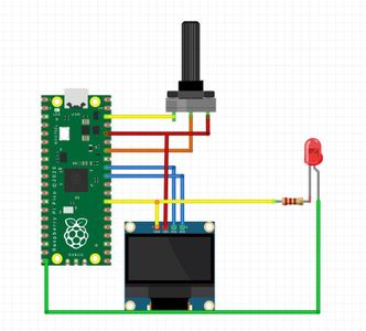

Step 7: Put It All Together: Raspberry Pi Pico + ADC + PWM +i2C OLED DISPLAY
In this step, to practice all features that we've learned so far, we would read a potentiometer, show the value on the oled and control the light of an led.
