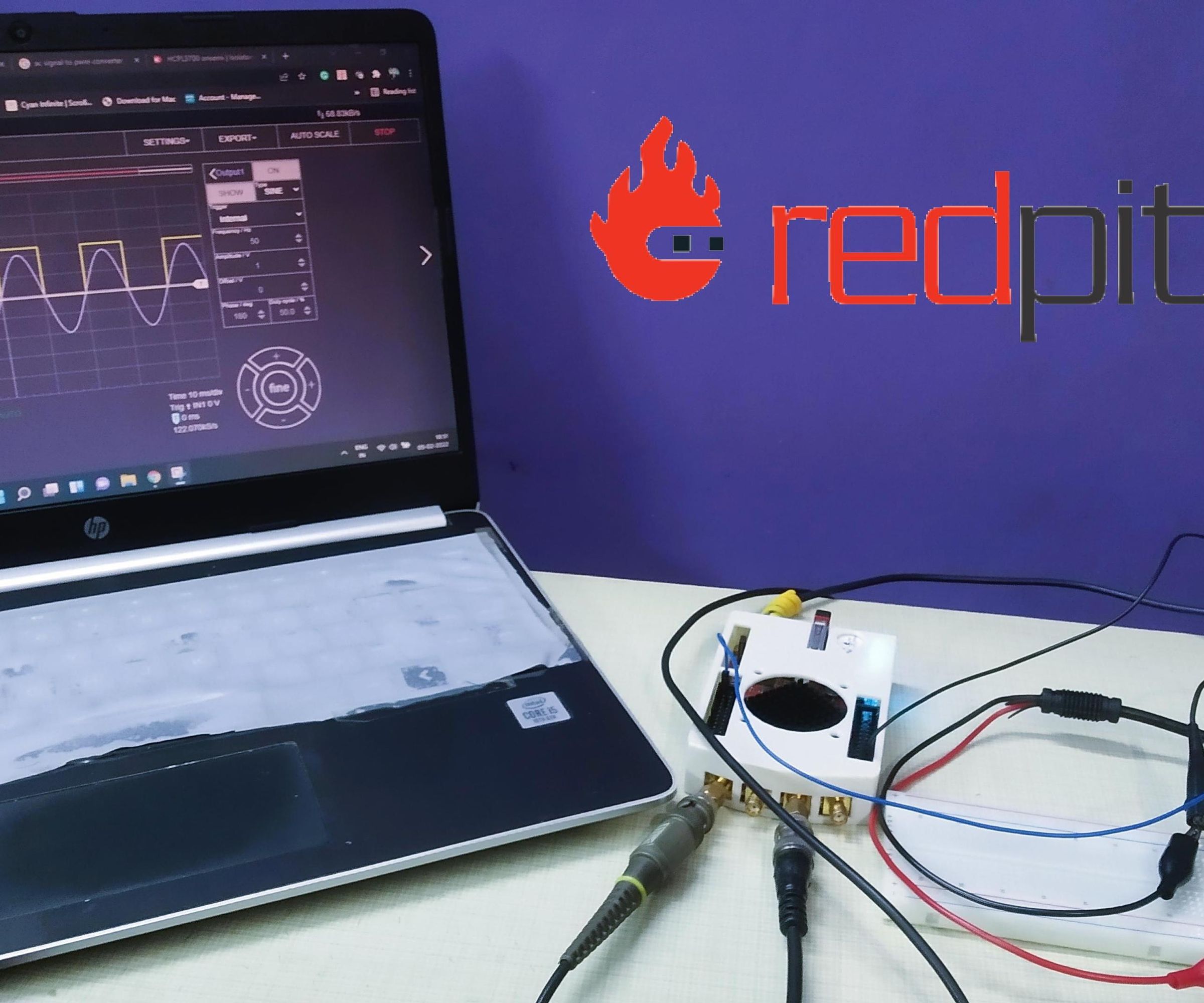

Step 5: Testing the Device
I have only tested oscilloscope and signal generator features till now which works pretty accurately, I faced some latency issues while using over a wireless network.
In the first image, I have connected the oscilloscope to the internal signal generator of the device which works properly.
In the second image, I have measured a pulse rating signal generated by Arduino UNO, which is very accurately measured on the device.
I have not yet measured any highspeed signal with the device, I would update this instructable later after measuring.
