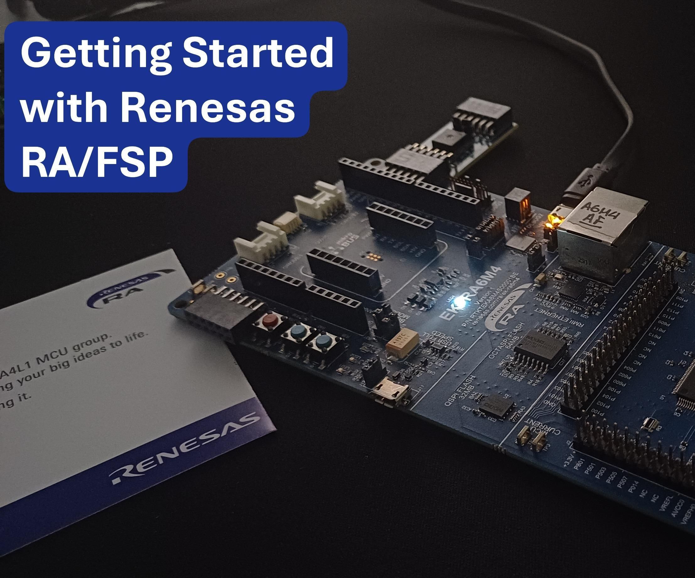

Introduction: Getting Started With Renesas RA Family/FSP - Part3 Visual Expressions
In this part of the series, we look at a very helpful debugging feature inside e² studio: Visual Expressions.
Visual Expressions let you watch and modify variables in real time, without stopping the CPU.
This makes it easy to observe timers, counters, flags, and state-machine transitions exactly as they happen.
We’ll go through enabling the Visual Expressions view, adding variables, and building a small demo.
While this tutorial works with any Renesas RA microcontroller, we'll be walking through the steps using the Evaluation Kit for RA6M4 as our example.
