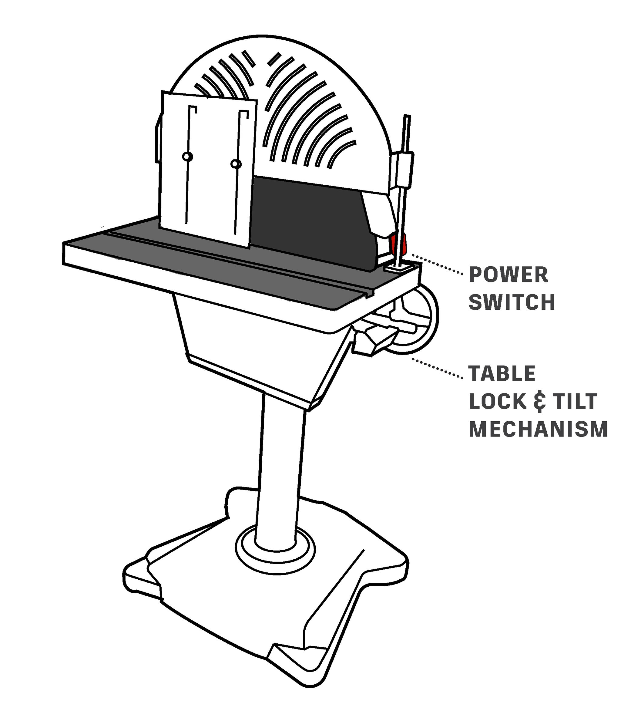

Step 2: Disc Sander

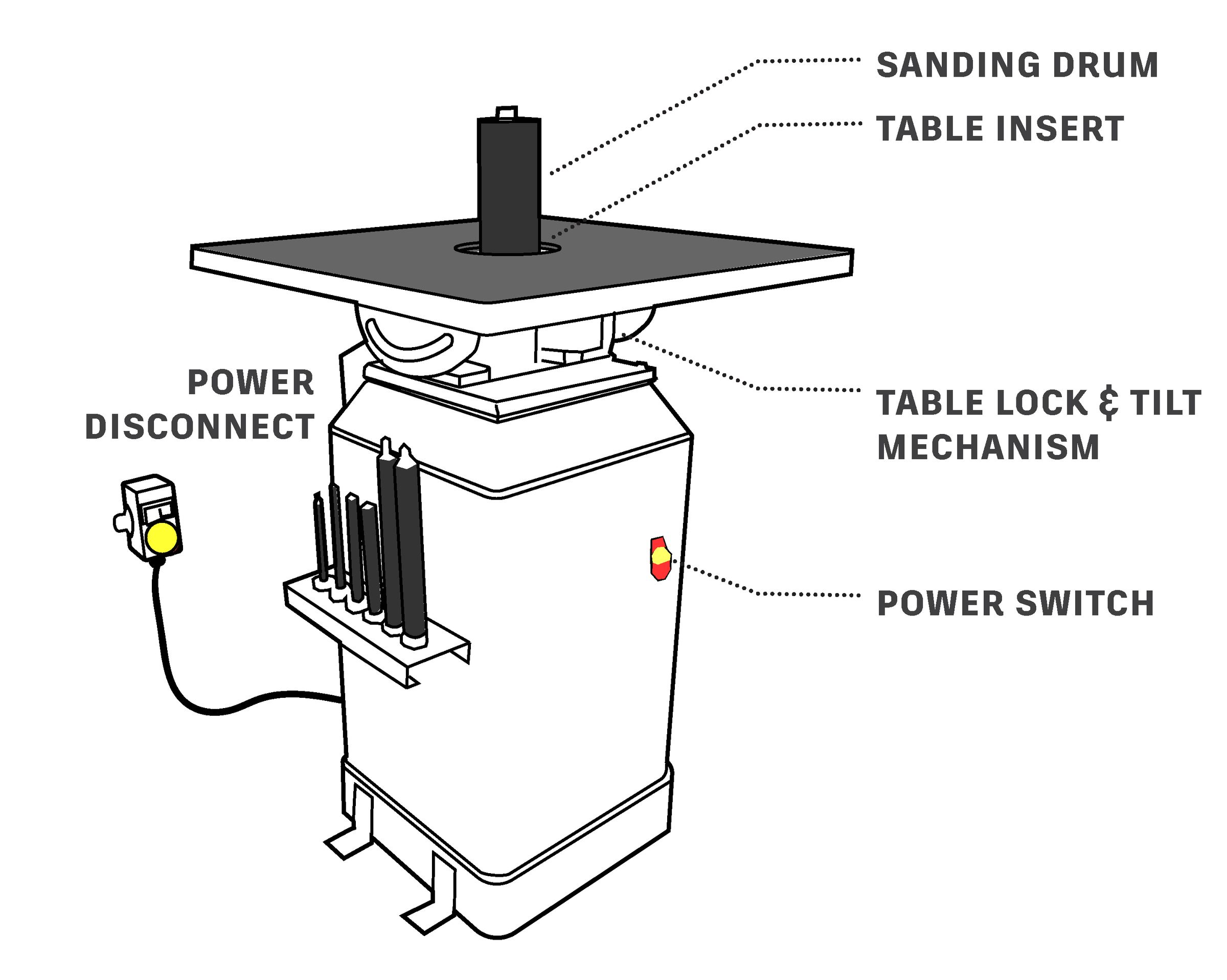

Step 3: Spindle Sander
