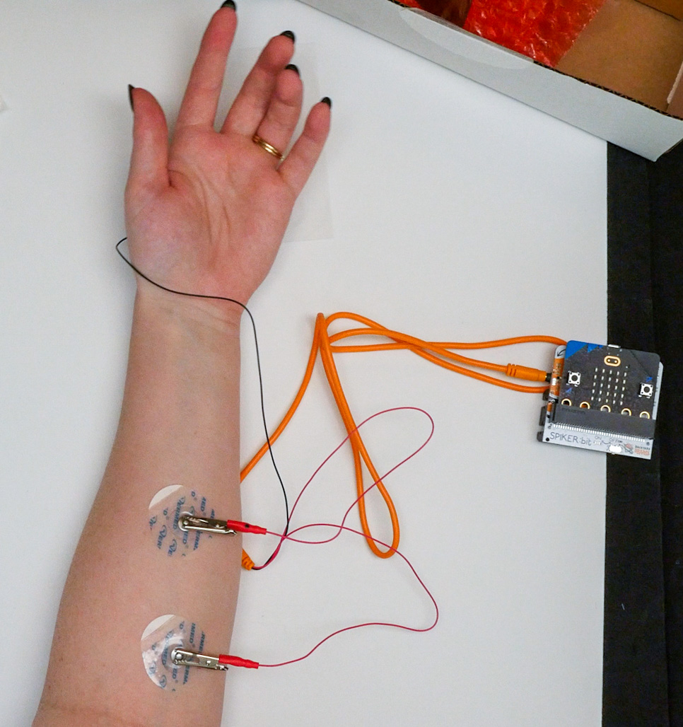

The micro:bit slides into the slot on the Spiker:bit, and the cable plugs into the port on the side of the board labeled “HUMAN.” You’ll also need two AA batteries, which go in the holder on the back side.
Next, you’ll need to place some electrodes on your body to read its electrical signals. We’ll start with the forearm muscle and stick the electrodes on so we can detect contractions with EMG or electromyography. Two electrodes go along the length of the muscle, and a third goes on the back of the hand. Clip the black ground cable to the electrode on the hand, and the two red cables to the other two electrodes; it doesn’t matter which is which. Don’t worry, the signals traveling through these wires are extremely small, and there’s no chance of electrical shock, I promise. That’s a lot of what the Spiker:bit board does, actually: amplify those faint signals so we can use them as sensor inputs for our projects.
The electrodes have a conductive gel inside that presses up against your skin as well as the metal bit on the outside. And remember that your body is largely made up of salt water, which is an excellent electrical conductor. So the signals from your nerves that are firing your muscles can be picked up through this method, which is called a BCI or Brain Computer Interface. If you’ve ever been in the hospital or had a doctor monitor your heart, you’ve probably worn this type of electrode before.
Once you’ve got your electrodes on and your board plugged in, you’re ready to read the EMG signal using micro:bit’s MakeCode website. You’ll need to install the Spiker:bit extension. Grab the file from Backyard Brains, click Import File on the extensions page, and choose the file you just downloaded– then you’ll see the Spiker:bit code blocks available with all your others.

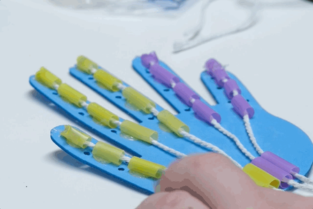

To take this even further, we can build a neuroprosthetic hand: this is a fun and simple project that mimics the movement of the flexor tendons in the fingers using strings, straws, and a single micro servo motor. Let’s put it together.
Hot glue tip: When you power up your hot glue gun, you should also be preparing to burn yourself with it. Not intentionally, of course, but it’s really easy to do, and the longer it takes you to cool down your skin, the more damage is done. So for this reason, I always prepare a bowl of ice water and keep it nearby when I’m using hot glue. That way, I can plunge my hand into the water as soon as a burn happens, which makes it a less severe burn, so I can get back to making.
Begin by cutting many small pieces of the straws, about 1cm each. Then glue the sides of the straw segments to the foam hand, being sure not to plug up the straw’s hole with glue. Install a string through each finger and glue it to the fingertip end.
The straws represent the flexor tendon sheaths, and the strings represent tendons. When the strings are pulled, the fingers flex. Please refer to the official guide for the neuroprosthetic hand kit for a more complete step-by-step tutorial.
The next step is to prep your servo motor to pull those strings. Attach the longest horn so that it’s perpendicular to the long edges of the motor casing. Next, cut a motor-sized notch in the corner of the included balsa wood, and hot glue the motor in place. If the wires are oriented away from the wood, that’s what will work best for this setup.
Next, glue the pencil along the length of the servo horn. You’ve got to be careful not to get glue on the main body of the motor, though. I think it’s cute that in this kit, the pencil you use to mark the wood becomes part of the project itself. Then tie one more string around the five tendon strings and glue it to the pencil.
The servo plugs into a port on the Spiker:bit. Then it’s a matter of writing some code to move the motor when the muscle signal exceeds a certain threshold, like earlier, but with an additional output. If you haven’t already, you’ll need to install the servo library in the MakeCode workspace. Then expand on the code we made earlier by adding a Servo block to the conditional statement.
Now when you flex your fingers, the servo moves and pulls the strings. You may need to adjust the strings and the servo horn to achieve the desired movement.
