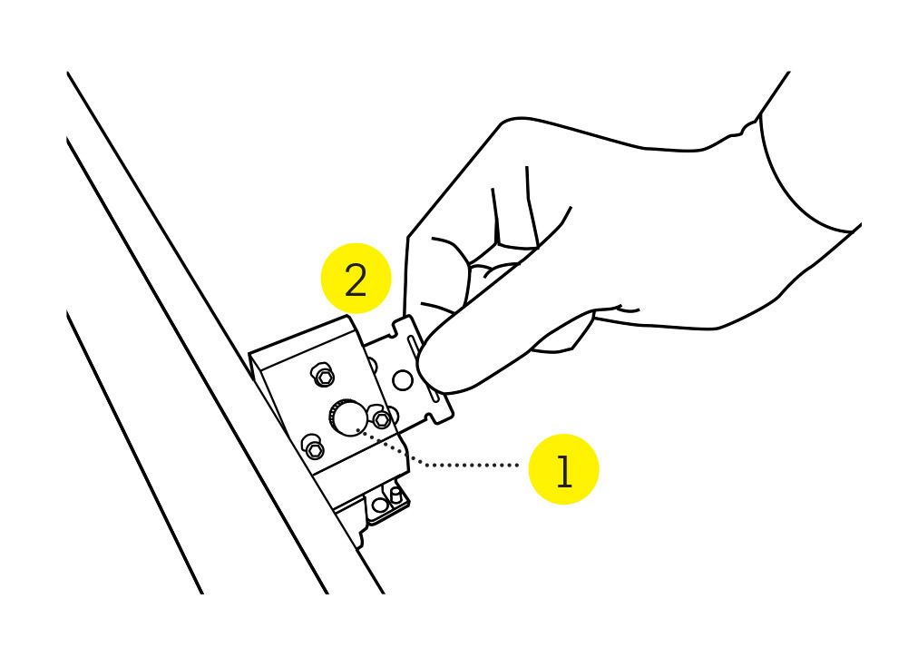

Inspect the mirror
- Loosen the thumb screw.
- Remove the mirror, and inspect.
- If the mirror is dirty, wipe it with a cotton swab dipped in the correct cleaner.
- Return the mirror to its holder.
- Gently snug the thumbscrew.
