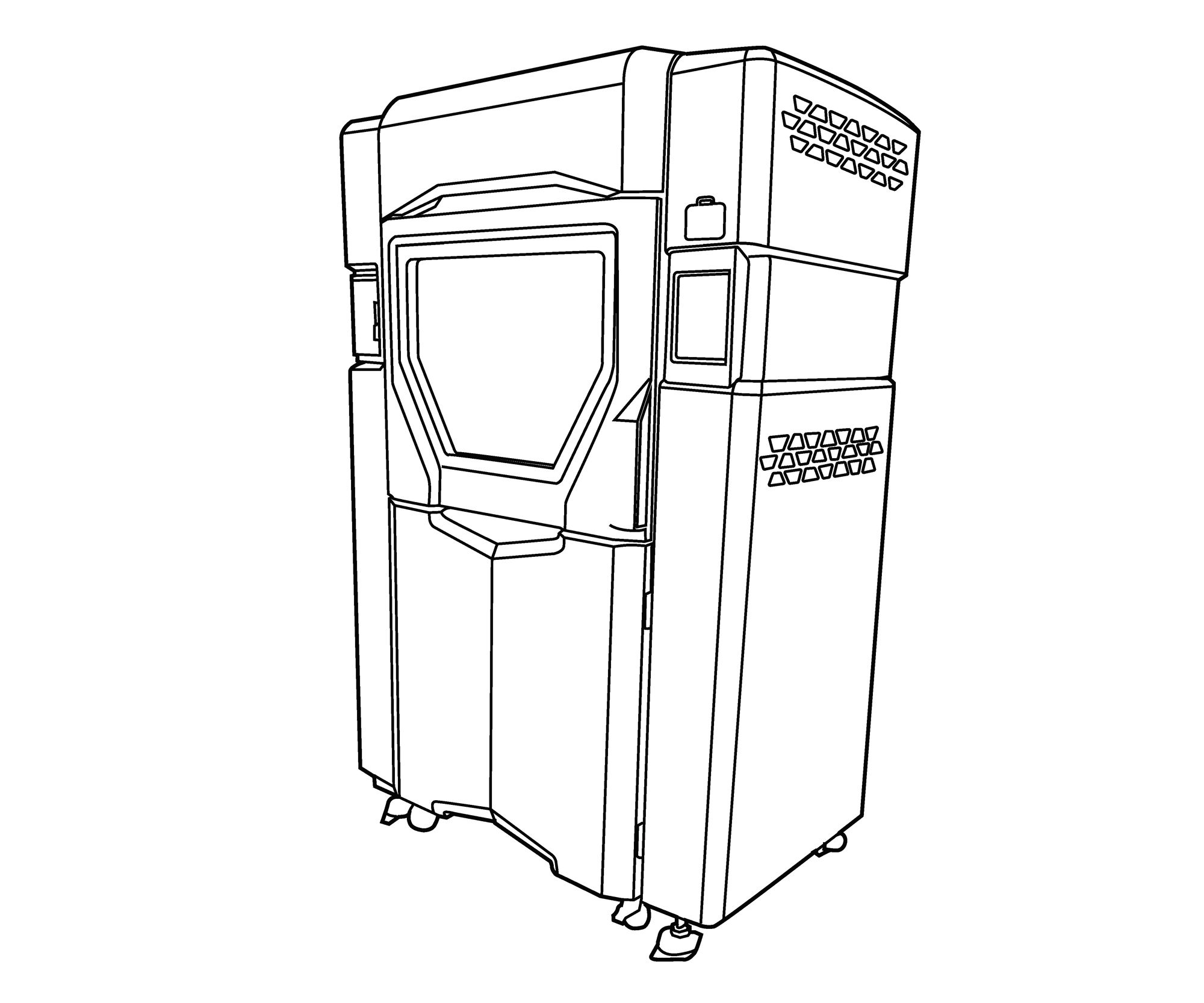

Step 3: Machine Specifications
The Fortus 450mc uses an additive manufacturing technology called Fused Deposition Modeling (FDM). FDM Printers work by heating and extruding a filament of plastic along a path to form a single layer. This process is repeated layer upon layer until the final model is created.
- Parts with an overhang will require support material.
- It will need to either be removed manually or dissolved in a chemical bath.
- The printer uses a 3D mesh file type called an.STL.
- This can be created in programs like Fusion 360.
- To print on the Fortus, you must use Insight and Control Center.
- These software packages are installed on all of the computers in the 3D Printshop.
- Each printer is loaded with a single Model Material and a single Support Material
- If your desired material is not loaded in any of the Fortus machines you can request a material change from Shop Staff.
- Build Envelope : 14" X 16" X 14" (35.5 x 40.6 x 35.5 cm)
- Layer Heights: 0.005" to 0.020" (0.125 to 0.5 mm)
