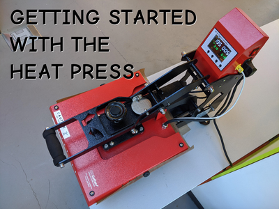

Step 1: Getting to Know the Heat Press

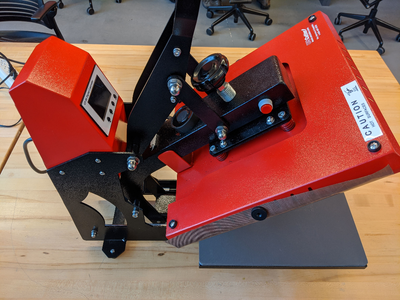

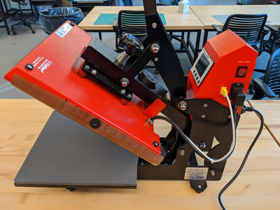

First things first, power on the heat press with the switch on the right-hand side. The screen will turn on and the heat press will start heating up to the current target temperature.
The screen is showing you a lot of useful information:
- the temperature scale it's currently using: you can choose between the Farenheit and Celsius scales;
- the target temperature it's currently set for: this depends on your fabric and your heat transfer vinyl;
- the target press time it's currently set for: just like temperature, this depends on your materials;
- the press time countdown: it does just that;
- the general counter: it shows how many times the heat press has been used.
On to the rest of the heat press!
- The top and bottom platen: they sandwich your materials on foam cushions and make sure to give your vinyl a nice, even heat for transfering;
- the pressure knob: it adjusts the pressure on the platen and your material. You usually won't need to adjust it unless your material is really really thick - rightie-tightie, leftie-loosie;
- the teflon sheet: it helps make sure no glue transfers to the foam on the top platen, and gives a smooth finish to your heat transfer design. It's held in place by a few very powerful magnets so we can remove it easily.
- the release button: if you need to open the heat press before the countdown is over, just push it!
If your material is very thick and the pressure for the top platen is way low, you will need to press and release by hand: the heat press platen will not lock and release on its own (and it's perfectly normal).

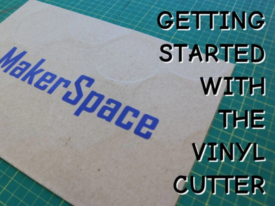

Step 2: Getting Started With the Vinyl Cutter
Since most people use the heat press for heat transfer vinyl designs, now is a good time to work on a design of your own! If you have little to no experience with vinyl cutting or vector design, check the Vinyl Cutter page on the MakerSpace website! It'll tell you all about our vinyl cutter, what it can cut, how to make your own designs...And there's even an in-depth online tutorial to get you started!
Once your design is prepped, cut out and weeded, it's time to set up your heat press!

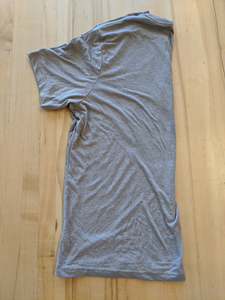

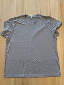

Step 4: Pre-heating and Center-crease Your Clothes
When it comes to custom clothes, many people like a nicely centered design. Here's how to center your art the easy way! This trick works for both cotton and synthetic fabrics - just make sure you have right temperature for the right fabric!
- Pre-heat your heat press to the correct temperature;
- fold your piece of clothing in half down the middle and line up the edges as much as possible;
- put your tee shirt in the middle of the platen;
- press for 2 to 3 seconds;
- unfold your garment and lay it on the platen.
That's it! You now have a crisp center crease you can use to position your design.This works from pretty much everything, from tee-shirts to hoodies.

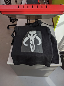

Step 5: Working With Cotton
Cotton fabric is relatively robust when it comes to heat-pressing, but the following temperatures and press times are only suggestions. Refer to the temperature and press time instructions that came with your heat transfer vinyl, and experiment with samples of fabric and vinyl to try and find a balance between the two!
First, set the press to heat up to 356 Farenheit/180 Celsius. Then, pre-heat and/or pre-crease your garment for 2 to 3 seconds.
For a single layer design:
- slide a piece of parchment paper inside your garment, covering as much of the vinyl area as possible between the front and the back;
- line up your heat transfer vinyl on your garment;
- press for up to 10 seconds;
- following the instructions for your vinyl, try to peel off the transfer sheet. If it peels relatively easily, peel everything off;
- if you're happy with the vinyl's finish, stop there! If not, press for up to another 5 seconds.
You're done!

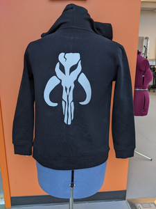

Step 7: Taking Care of Your Heat-transfer Design
Congratulations on your heat press design! To make it looks great for a long time, here are a few pointers:
- don't wash your garment right away: the glue that worked its way into the fabric needs at least 24 hours to cure, maybe even more: check the instructions that came with your heat-transfer vinyl!
- Wash your garment inside out: it will keep your transfer protected;
- iron your garment inside out: you don't want that hot iron to risk melting your design!
This guide is just enough to get you started, there is a lot yet to learn! Fine-tune your heat press settings for different fabrics, different vinyl brands, write everything down so you don't have to re-discover everything every time - and have fun!

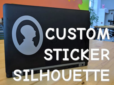

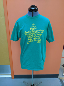

This guide is just enough to get you started, there is a lot yet to learn! Fine-tune your heat press settings for different fabrics, different vinyl brands, write everything down so you don't have to re-discover everything every time. Try some of our other vinyl cutter tutorials and adapt them for heat-transfer designs! Facilitator Thomas used our tutorial on Custom Sticker Silhouette at https://www.instructables.com/id/Custom-Sticker-Silhouette/ to make tee-shirts inspired by Japanese manhole covers.
