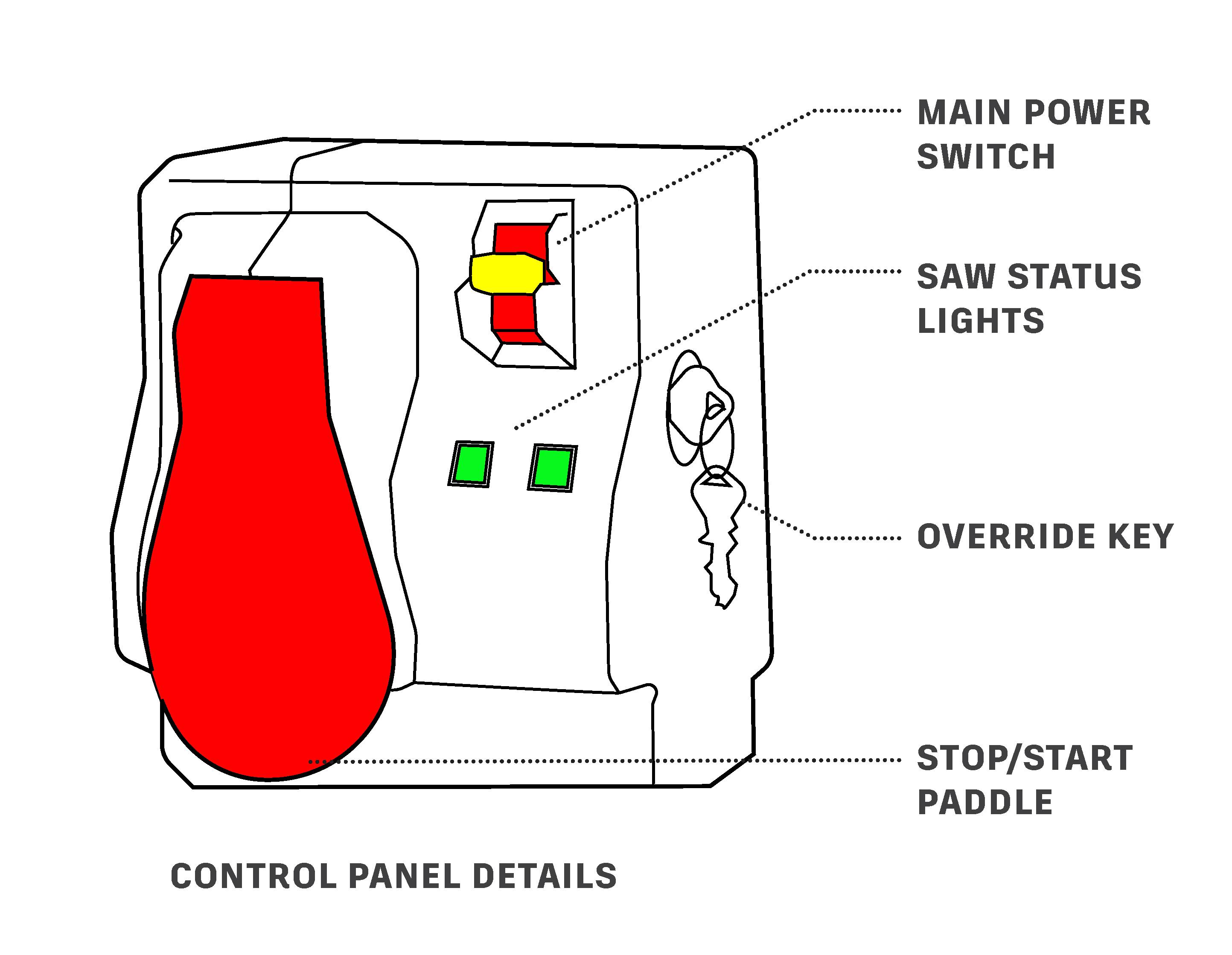

The SawStop at Pier 9 has a safety feature that stops the blade in 3 to 5 milliseconds if the blade contacts an electrically conductive object, like a finger.
Some common materials will cause the system to trigger.
If in doubt, ask Shop Staff for assistance.

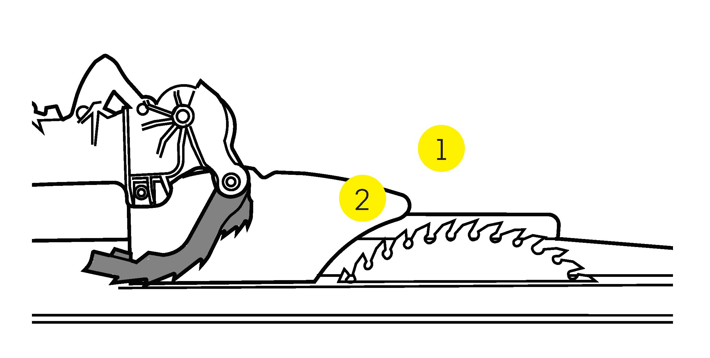

Step 4: Kickback
Kickback is what happens when the workpiece is violently thrown from the saw. Causes include material trapped between the blade and fence, or a misaligned fence.
The riving knife (splitter) (1) and anti-kickback pawls (2) work together to help reduce kickback. Always use a splitter except when dadoing. Use anti-kickback pawls whenever possible.
See Shop Staff for cuts that require their removal.
