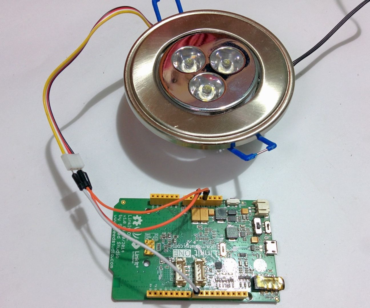

Hope you had fun looking at the LED blink at the interval you set, now it is time to create a pattern using a few LEDs. For this example, connect all the cathodes of all the LEDs together and anode to the LinkIt One digital pins. I'm using pin 8,9,10,11 of the LinkIt One, you can use any other pin, but make sure to edit them in the program.
Connect the Cathodes to the LinkIt One board ground pin. And then upload the program below. You should now see the LEDs go On and off in a pattern. You can edit the code to create the pattern you like.
