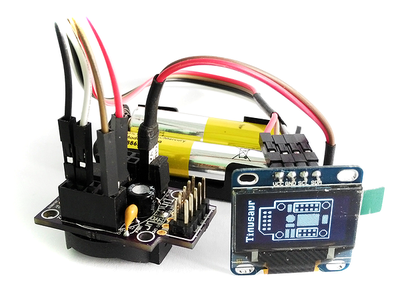

Introduction: Getting Started With the Tinusaur Board

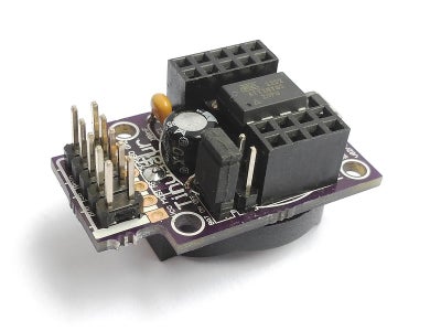

The Tinusaur is a small board that has a DIP-8 socket for an Atmel ATtiny85 (or ATtiny25/45, even 13) microcontroller with the minimum required parts to work which is pretty much 2 capacitors for the power source and one 10K pull-up resistor to the RESET signal of the microcontroller.
On both sides of the MCU socket there are 2 double row female headers that could be used to connect external components like LEDs, buttons, sensors, etc. The inner rows are the signals from the MCU while the outer rows are the GND. Those headers could be used (in same cases) like a breadboard.
There is also 10-pin male header to connect the external ISP programmer such as USBasp.
On the bottom of the board there is a battery holder for CR2032 - a button cell lithium battery rated at 3.0 volts.
A pair of 2-pin male headers are available to connect an external power source and (with additional jumper) to disconnect the coin cell battery.
At the corners there are 4 holes - 3 mm each, that could be used for mounting the board.

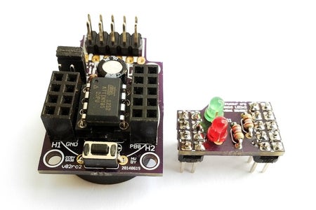

Step 1: Parts - What's in the Package
Here is what's in the package - 15 different components ...
- PCB - Printed circuit board
- MCU - Atmel AVR ATtiny85 microcontroller
- Socket, DIP-8 socket for MCU
- H1, Header 2×4, Female
- H2, Header 2×5, Female
- ISP, Header 2×5, Male, for ISP
- RESET, Button - Tactile push button, for RESET
- Power Header 1×2, Male, for external power
- Battery Header 1×2, Male, for battery power on/off
- Battery Jumper, 2-pin, for battery power on/off
- C1, Capacitor 100nF, Small
- C2, Capacitor 100uF, Low profile 5×5 mm
- R1, Resistor 10K, Small, 1/8W
- Battery holder for CR2032
- Battery 3V, CR2032

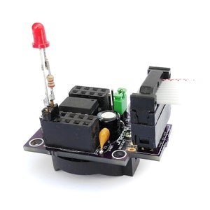

Step 2: Assembling the Board
Assembling the board is very easy. At one of the workshops organized by the Tinusaur team there were people of age 16 to 44 who did that without any significant issues.
On the PCB board there are markings where and how to put the components.
There are only 2 components that should be soldered in a specific direction:
- The socked for the microcontroller - it has an identifying notch that marks the top, the PCB has a mark for that notch as well.
- The 100uF capacitor - it has (+) and (-) signs - there are the same mark on the PCB too..
Here is the recommended order for soldering the parts:
- MCU socket. Note: do not insert the chip yet.
- Capacitors C1, C2 and resistor R1.
- Headers H1, H2.
- External power header – red.
- Battery on/off header – yellow.
- ISP header.
- Battery holder.
- RESET button.
Please note that the battery holder should be soldered before the button.
Some more details and recommendations for assembling the board could be found on this page: http://tinusaur.org/guides/tinusaur-board-assembling-guide/.

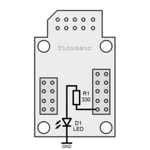

The "Hello World!" of the microcontrollers is a program that makes a LED to blink.
For this we also need a LED connected to the GND and to the Vcc through a 300 ohm (or 270 ohm) resistor.
It is a very simple program.
#include <avr/io.h>
#include <util/delay.h>
#define LED1_PORT PB0 int main(void) { DDRB |= (1 << LED1_PORT); while (1) { PORTB |= (1 << LED1_PORT); _delay_ms(200); PORTB &= ~(1 << LED1_PORT); _delay_ms(400); } return (0); }
