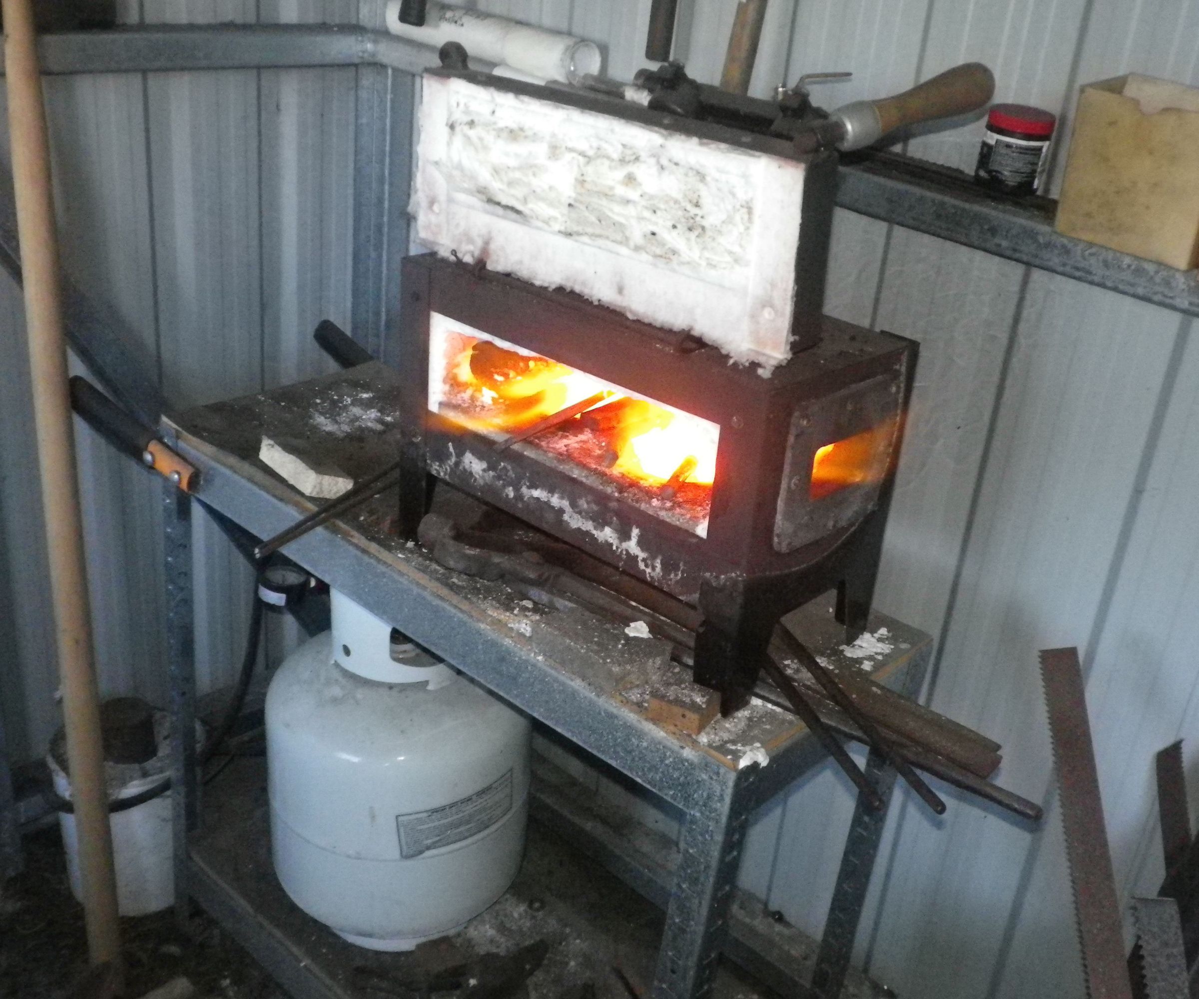

Usually printing houses have a deal with a jewellery casting house, so if anything goes wrong with the casting house another wax can be printed, and recast at their expense.
At this point all the metal casters will be screaming, "but I can cast this at home!"
This is a very true statement, but when you are talking 18ct yellow gold, it will cost you at least 3 to 4 times the price the casting house will charge you.
The reason for this is that when you cast metal you need 3 to 4 times the weight of metal for the casting button. When the casting house casts your ring, they only charge you for the gold used for the ring and a casting fee, they keep the scrap.
"Ha!", says the home caster. "I can use the scrap myself for other projects".
Again this is true, but it means you always have a lump of gold sitting around doing nothing.
Gold is expensive.
If there is anything wrong with the casting from a jewellery casting house they will recast at their expense, not yours.
