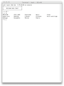

So now lets get that music.
(Picture 1)
Open Terminal again and type "cd ~"
this command just changes the current directory to your home directory.

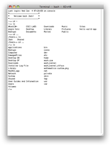

(Picture 2)
now we'll go a little deeper into the hard drive using the "cd .." command a couple times while listing the files using the "ls" command each time to keep looking for that iPod.

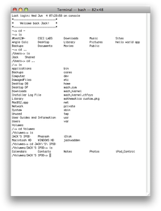

(Picture 3)
All external and internal hard disks are in the "Volumes" directory so lets get in there by typing "cd Volumes" and then listing the contents of the directory again. Your iPod's name should show up as one of the directories. Mine is called JACK'S IPOD. In order to get in all we have to do is... you guessed it type "cd "ipodname"" and we're in!!!
NOTE:
If your iPod's name has spaces or apostrophes like mine, it may be easier just to type the first couple letters and then hit tab. In Terminal, tab is an "auto-complete" button and guesses the correct answer. Very useful when you don't know Unix syntax.

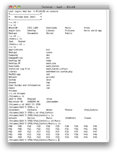

Step 3: Now Lets Find That Music!
Here comes the fun part! At this point you should be inside the iPod. If you haven't already, list the files in the iPod directory and for fun, open up the iPod in Finder as well. Notice anything funny?
There's an extra file in there that Finder won't let you see!
it's called iPod_Control... kind of ironic, no?
and this is where your music lies.
(Picture 7)
Lets explore! Type "cd iPod_Control" and then "ls"
"Music" should be one of the directories listed so lets try there. Type "cd Music" and then "ls"
At this point (depending on how much music you have) you should see a lot of files pop up F00, F01, F02 ... and so on. These files contain all of your iPod's music! and are what we've been looking for.
Feelin' kinda sneaky huh?
(Picture 7)

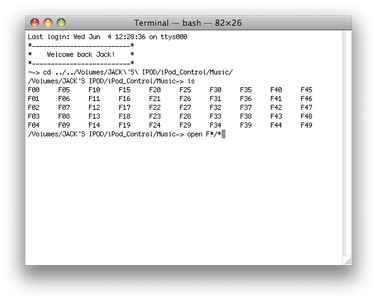

Step 4: Transferring the Music to ITunes
Now what? If you were industrious you went into the folders and saw a bunch of .mp3 .mp4 .m4a files with random four letter capital names. That's your music alright but it's sorted and categorized in a funny iPod manner which I don't understand.
No worries!!! It doesn't matter anyway because when we open the files it automatically copies the song to iTunes Library and puts it in the correct format*!
I'll spare an explanation of wildcards except for that the * character means "everything" to the computer. So instead of individually opening every file in every F## file I can just tell the computer to open all files in all F## files!
(Picture)
VERY IMPORTANT!!!
-First, make sure you have enough time to copy all music. Depending on how much this could take a VERY long time.
-Second, beware that this will copy ALL MUSIC from the iPod even if you already have copies of some of the songs so prepare to delete some doubles.
-Third, make sure you are in the "Music" directory when you type these commands in. If you're in an F## file just type "cd .."
Type "open F*/*"
which in computer speak means "open every file in every directory starting with F" which is exactly what we want!
Now watch in satisfaction as every music file on your iPod is copied to your iTunes Library!
