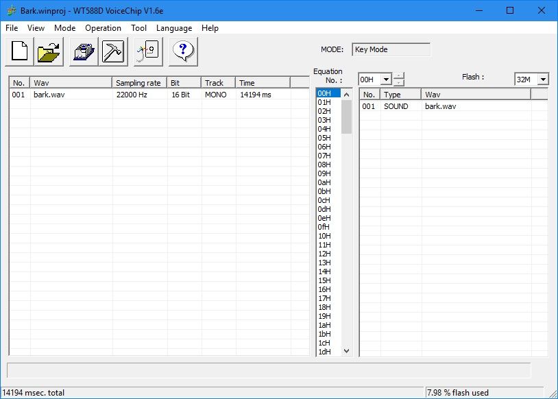

The left pane is where the sound files are loaded. The middle ‘Equation No.:’ is the selection of the 220 sound combinations. The right hand pane is where the sound combinations for each ‘Equation No.’ is entered, referring to the list of sounds in the left hand pane.
One sound, Key trigger example
This will give us a standalone sound module where a Barking sound is triggered by an input pin.
Get a sound file e.g. from http://soundbible.com/ and process it on Audacity.
Create a new folder called e.g. Bark. Start the WT588D VoiceChip V1.6 program. Change the language to English as above.
Start with a new project: File>New Project and enter a project name and select the folder. Note some keyboard characters are not recognised.
Add files: Right click in the left pane, select Load and browse to the sound file and click Open.
Set the sound selection: right click the right pane (with Equation No: 00H highlighted), select Insert.

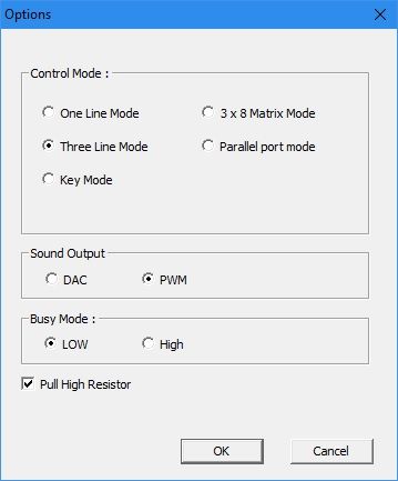

We now need to set the input and output modes. Click the hammer (or Operation>Options). Set Control Mode to Key Mode. Set Sound Output to PWM if connecting a speaker direct to the module or to DAC if using an amplifier. Busy Mode can be either. I default to setting this LOW and connecting a LED from the busy output (Pin15) via a resistor to 5v. Leave the Pull High Resistor ticked. Click OK.

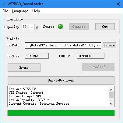

Now start the Download tool via Tool>Download Data. Click connect, the status red circle should change to green. Click Erase to clear the module. Then click DownLoad. Alternatively click OnekeyDownLoad to do these in one operation.

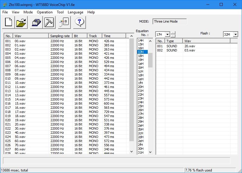

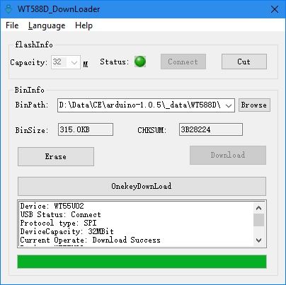

Now select the ‘Equation No.’ to edit. Then right click the right hand pane, Insert, and add either a .wav file or a silence period. Selecting .WAV brings up the list of sounds loaded earlier into the left pane.
For the system to speak numbers from zero to 100 I loaded the processed sound files for zero to 20 plus 30, 40, 50…..100. So the sound for ‘23’ is created by the sound for 20 plus the sound for 3 and so on.
With the sounds loaded and collated we need to set the control and output parameters (Operation>Options). For multiple sounds we want the three wire interface. Directly connected speaker needs PWM. Use of an amplifier would need ADC. Leave the Pull High Resistor ticked. Click OK.
