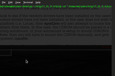

Change your working directory to the "bin" folder inside your newly extracted archive:
All OS's: Type (without quotes) cd then a space. then drag the bin folder into the command line window. You shoud have something like the following:
Mac OS X/Linux:
cd '/home/mdryden/Argyll_V1.0.4/bin/'
Windows:
cd "C:\Program Files\Argyll_V1.0.4\bin\"
Hit enter.
If you are using the Spyder2, like me, you need to copy the device's firmware from the manufacturer's CD. With the CD in the drive, simply type ./spyd2en(Mac/Linux) or .\spyd2en.exe (Windows) and hit enter. See here for more details.
Mac OS X/Linux:
Windows:
Hit enter.

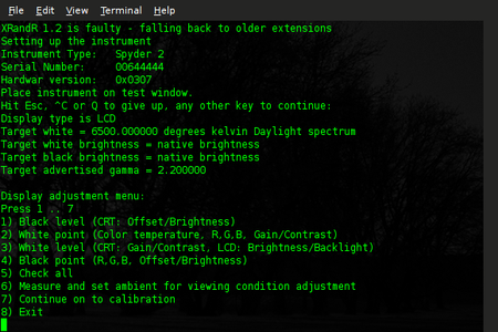

A grey square should appear in the centre of the screen. Place your profiler over that square, and turn out the room lights if possible. Hit Enter. You are now presented with a list of operations dispcal can perform.
First we want to adjust the white point of the display. If you're on a laptop, you can skip this step since there are no colour controls.
Choose "2) White point (Color temperature, R,G,B, Gain/Contrast)".
The square will flash different colours for a second then you'll see something like this at the bottom of the window:
/ Current Br 102.33, x 0.3175, y 0.3403 DE 6.0 R- G-- B+
Find your monitor's custom colour settings and adjust the Red, Green, and Blue settings so that the number after DE is as low as you can get it. Follow the symbols after RGB at the bottom of the window; if there are two minus symbols after G, then you need to reduce the amount of green. When finished, hit the space bar. If your monitor lacks custom colour settings, set its temperature setting as close as possible to the colour temperature you picked above
