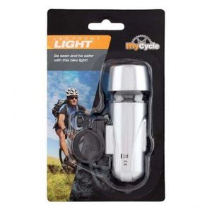

Other parts bought were a Bike light from the pound shop, a head torch from the pound shop, and paint. Everything else I had in my junk box.

This bottom half of this is the PVC pipe reducer, painted half with matt black acrylic and half with silver. On top of that is glued the cap/lens from the pound shop bike light. A small bolt from an old Xbox 360 is screwed into the pipe reducer side wall. Done!
