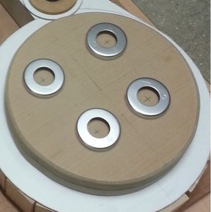

The light lenses on the cyclotron are 4 metal cover discs from door handles with red clear perspex discs in them. Holes will be cut into the MDF to accept the metal covers later using the plans to measure out the centres from the centre line of the cyclotron.

The lights in the cyclotron are quite straight forward. Using the plans, I marked out where they needed to be. Using a spade bit the same diameter as the metal rings, I drilled holes to a depth of about 5mm. This allows the rings to be recessed into the cyclotron. Now using a smaller spade bit that was the same diameter as the 35mm film tubs, I finished the holes. The 35mm film tubs were pushed in from behind until flush at the front. 4 discs were cut from 2mm red perspex to be used as lenses. You could use anything that's red and transparent here really or just even paint the bottoms of the film tubs red. Hot glue the film tubs in place. Be careful however, the film tubs can melt quite easy.
Using small pieces of Veroboard to mount 2 x 10mm red LED's, that were then glued to the inside of the film tub lids with the wire coming through a hole in the lid. The film tub lids are then just put back on the film tubs.
